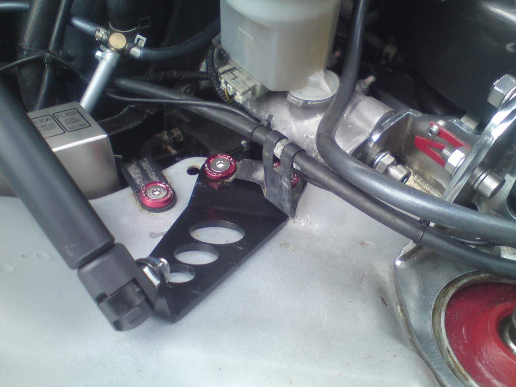

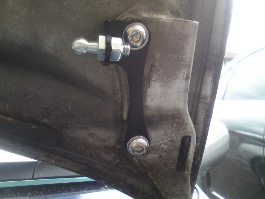

The bolt wasn't there to begin with so I went to put in the one provided in the kit put it's not screwing into anything and then falls out. The hole must be threaded, could I get my mechanic to tap it?? The bonnet is pivoting when it's being closed which is going to bend the corner or pull out the other bolt
Running the same size tap through may be enough to get the bolt in, though doesn't really sound like it if it's falling out after going in. I would try a helicoil or drill it out and tap to a bigger size
You may need to drill a bigger hole in the bracket depends on size and get some bigger hardware to accommodate the bigger tap but that's what I'd Go for

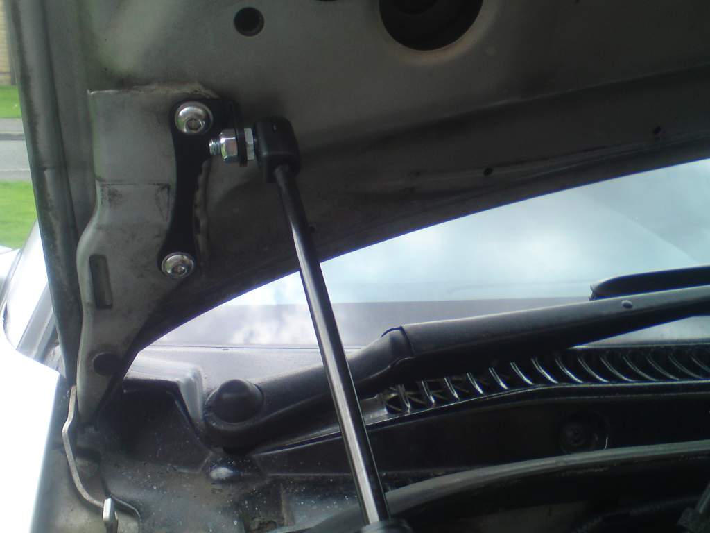

I too noticed the flexing if you treat it rough, suppose i could put a further nut/bolt in higher up but it's not bothering me greatly, my brackets are the later ones than the ones in this particular video fyi.

Been busy enough the last couple of days, got myself a threaded plug to fix my dilemma with the bonnet hinge, slots in and you then pull it back and it crushes against the inside of the hole:thumbup1:

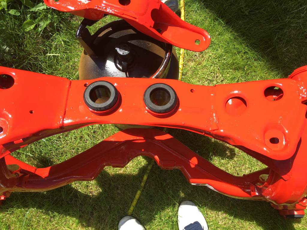

Ripped/burnt out the diff bushes and installed my new Energy Suspension ones, went for black to contrast against the red, tidied up the subframe with another nice layer of red:thumbup:

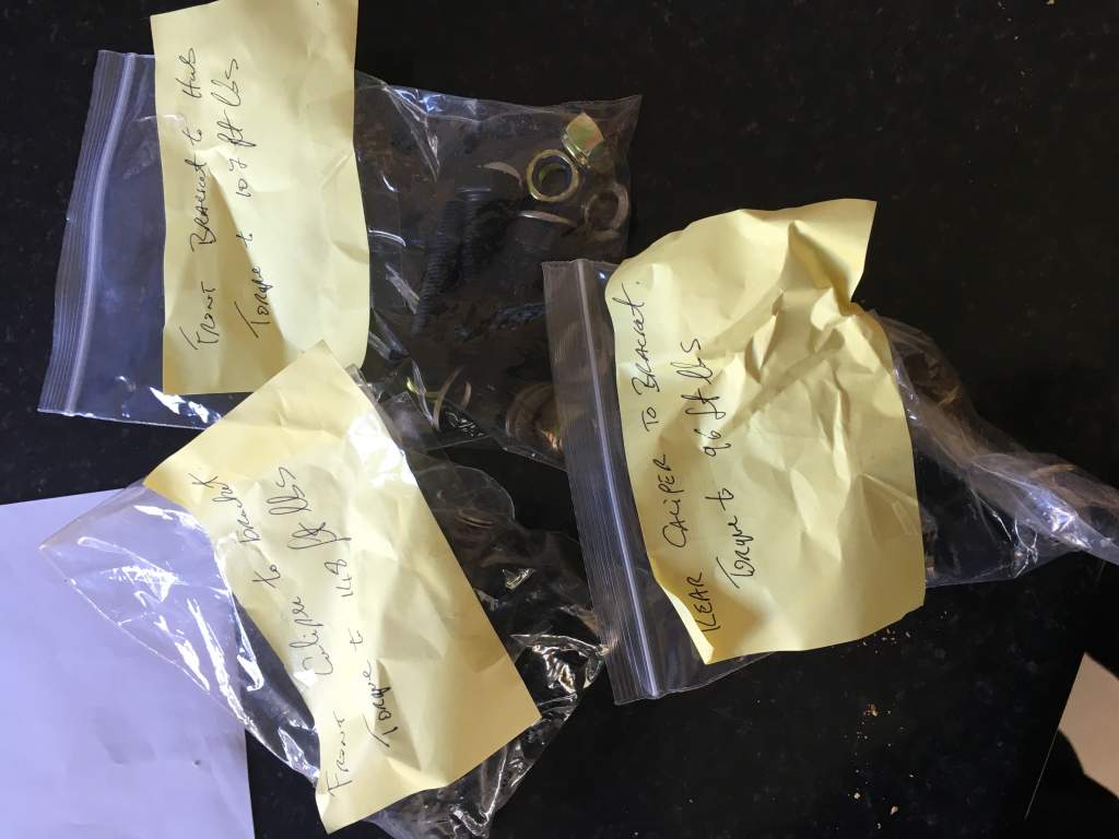

Fitted my brake brackets to the rear hubs in preparation for my freshly powdercoated calipers (not ready yet) and organised all the fittings into seperate labelled bags.

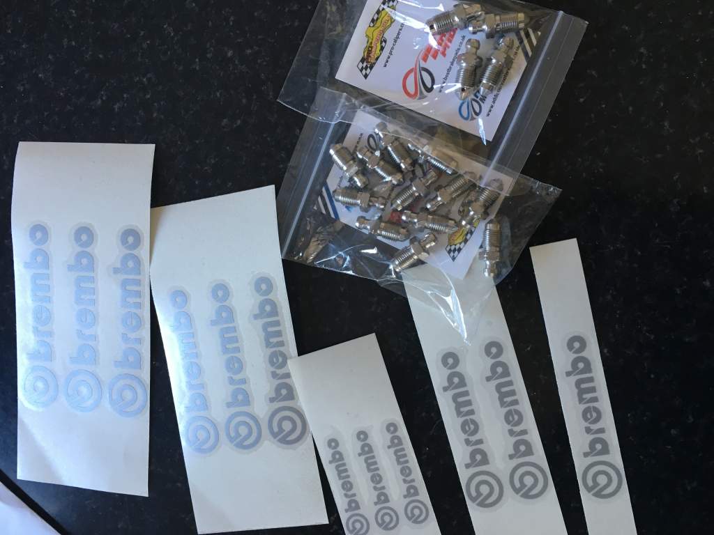

Another packet arrived containing the Brembo decals and stainless steel bleed valves for mine and another set of Evo calipers that are being done also:thumbup:

Fitted my Winfactory bonnet struts, they could have marked which bracket went where instead of trial and error, more issues, as my car didn't have a bolt on the bottom passenger side bracket, I was happy to fit the new Winfactory bolts only to find that the reason there was no bolt is due to the fact that it just falls back out, must be threaded. This is means that the struts are putting too much pressure on the bottom corner of the bonnet, can I do anything to rectify this??
[ATTACH=CONFIG]99307[/ATTACH]
You could drill the bracket hole slightly bigger and then tap the bonnet hole and fit a corresponding bolt.

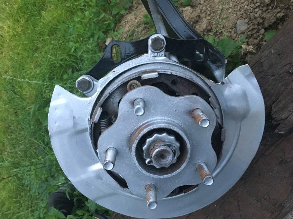

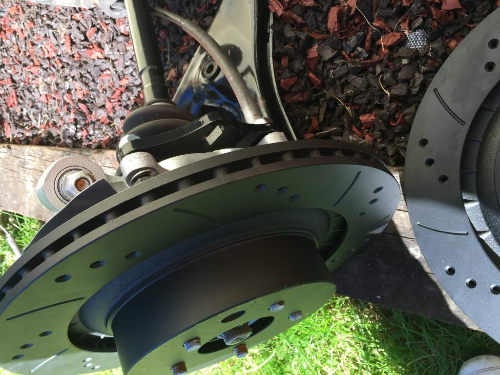

Cut the dust guards to allow for bigger rear calipers
[ATTACH=CONFIG]99533[/ATTACH]

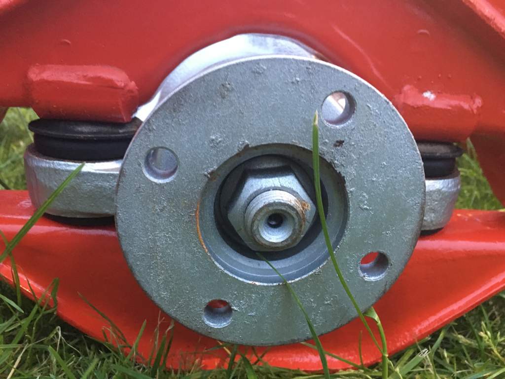

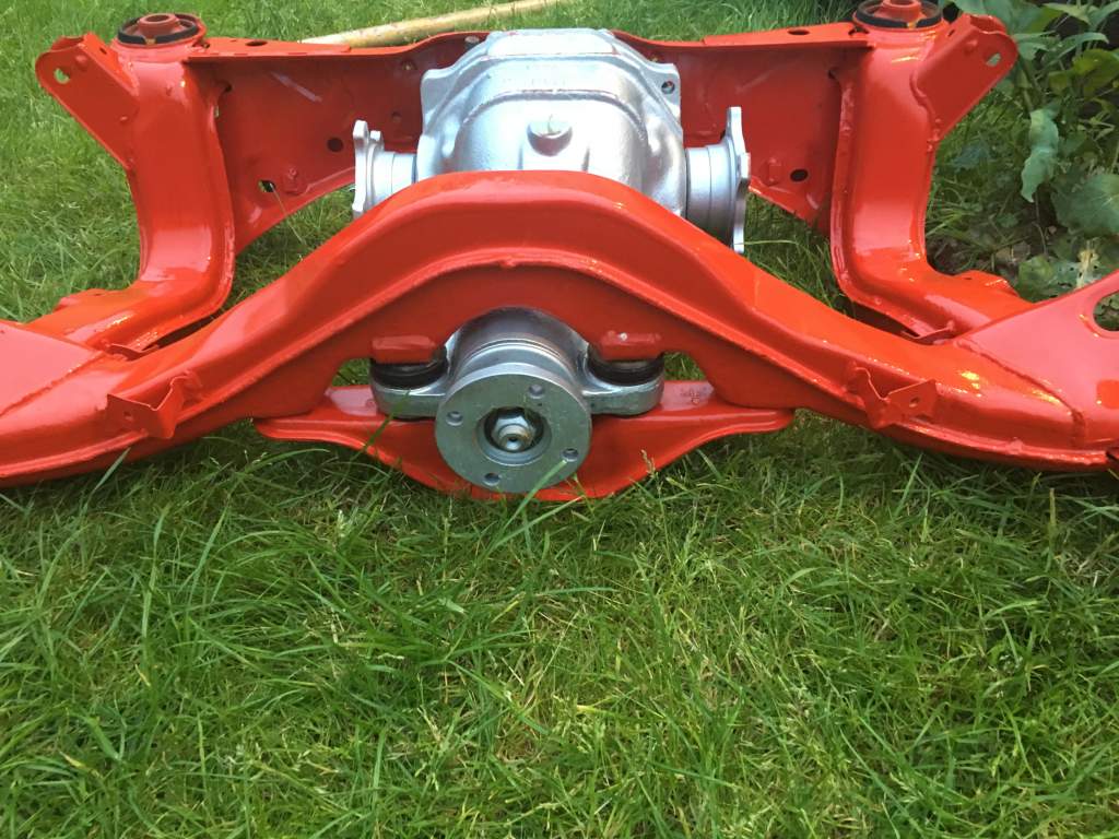

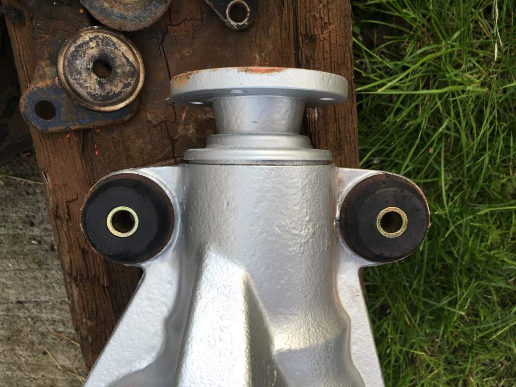

Refitted the diff with the Energy Suspension bushes.
Are they fitted correctly??
I put the metal plate at the top ??
Hi, I had to check my pics and I fitted mine the same as was stated on the leaflet that came with the ES bushes..so yes its correct.
Cheers matey, I followed the instructions also but I just thought it didn't look right:yes: I'd heard stories of how hard it is to refit the diff to the subframe but mine bolted straight in. I put it together while grilling chicken fillets on the BBQ, thought I must've done something wrong for it to take only 10 mins:thumbup:

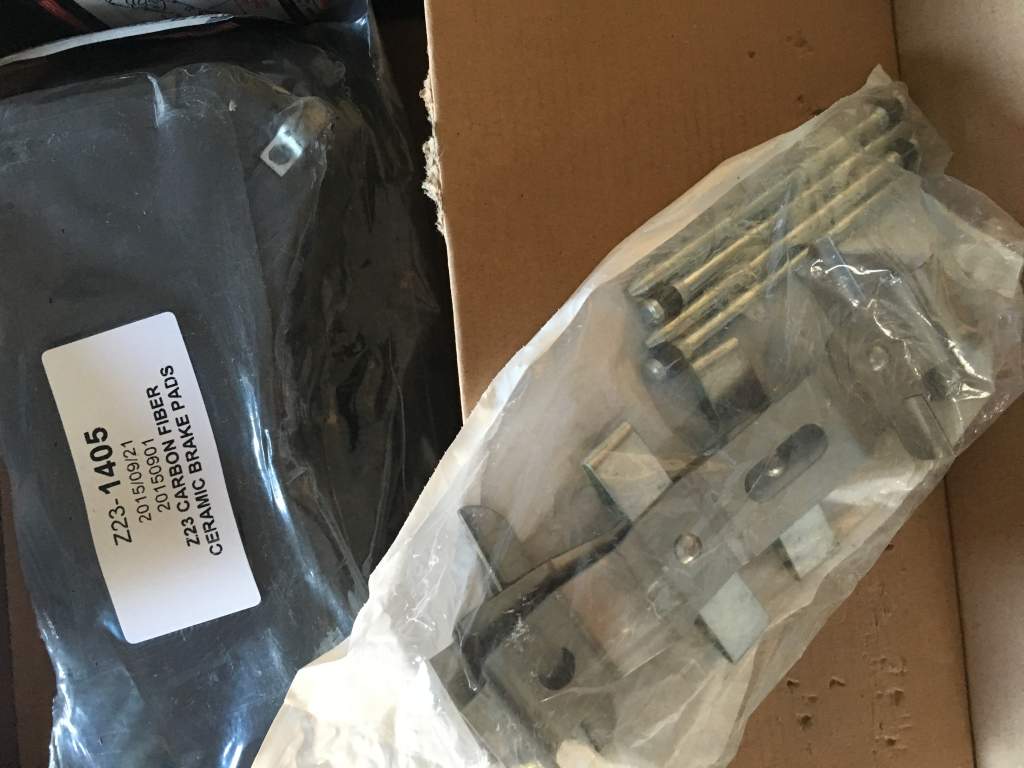

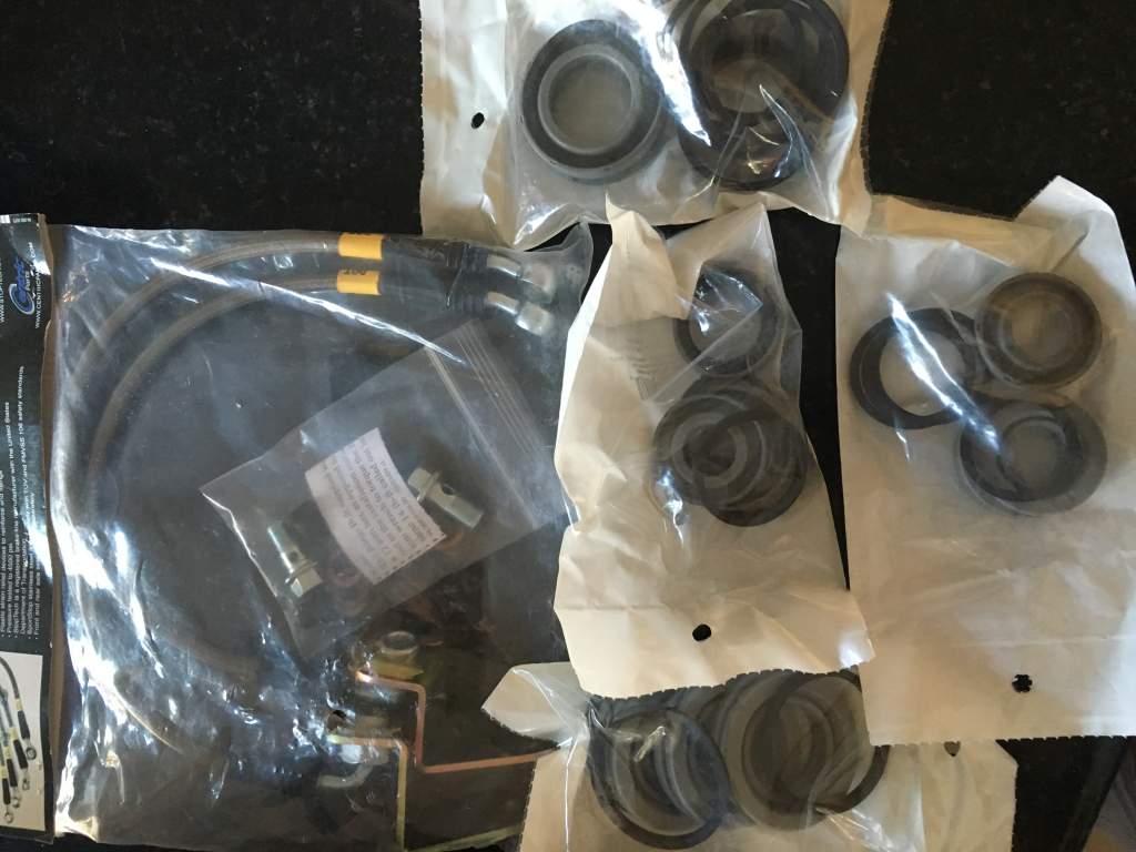

More goodies in the shape of Braided rear brake lines, rebuild kits for the Brembo's, pad springs, pins and mahoosive carbon ceramic brake pads:punk: (fit the R35 GTR):bow::bow:

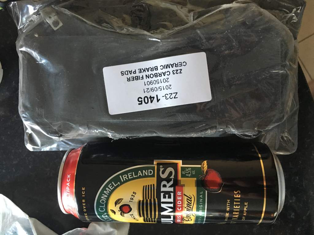

Pic next to a 500ml Cider can for comparison
Put the boot into the Powdercoaters on Saturday, so should have my newly painted calipers sometime this week:thumbup:
For a Z23 lol. Take it these don't fit our normal brakes
Ha! I found that amusing too Lee, no, they won't fit z32 calipers:biggrin: the pads are bigger than a 500ml can and way bigger than regular calipers:whistling: They will fit my upgraded Brembos and the R35 GTR calipers. I can't wait to get my calipers back and start rebuilding them, hopefully ready to fit by next weekend :clap:

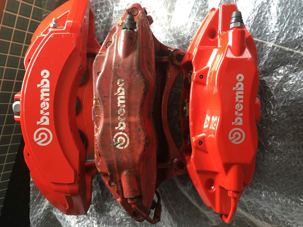

Quick pic from earlier to give you an idea of size
The top is the SRT8, the middle is Evo8 and the bottom is for the rear:yes:

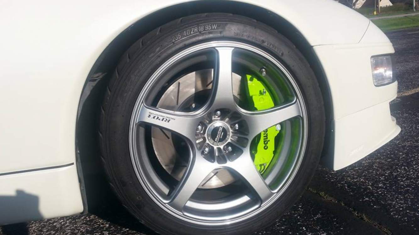

Ah right, gtr sized. So 6 pot fronts and 4 rears?
Apologies, the green ones are actually Porsche calipers, here's the SRT8's on a Z
