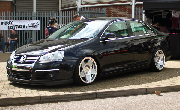

Possibly a bit of an unusual choice for a zed, but lkperformance list 18" 3SDM 0.05s in 114.3 so I might give them a shot, I love their retro look and think they'll look awesome, remind me of Modenas which I like on zeds
