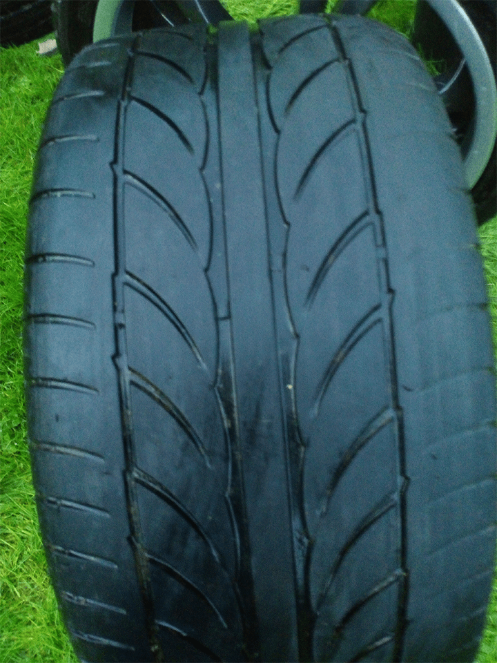

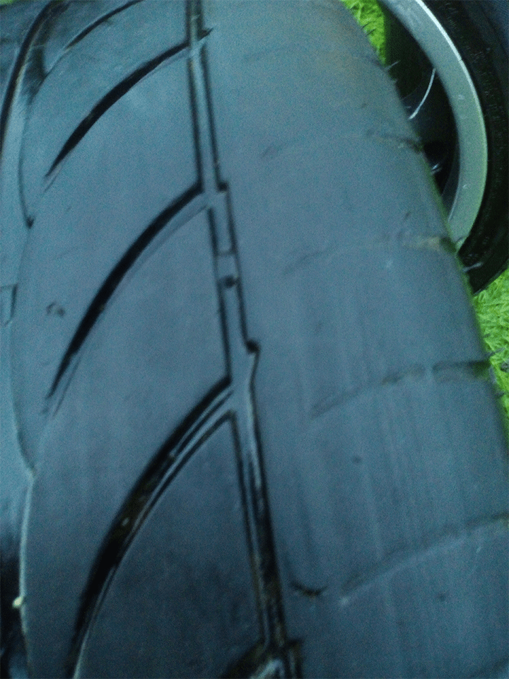

I have them on used wheels got and was weary if they are too worn on the inside to be legal. they are not worn down to the depth marking, but have mostly worn off the tread on one side.
Thread depth must be more than 1.6mm over the central 2/3rds iirc. So those look like they are probably legal. However wether I'd run them is a different question. Check the date on the side to. Looks like the previous owner liked lots of camber.

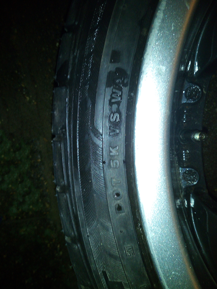

I looked on both sides and couldn't see a manufacture date, all i know is that the tyre is a "Achilles ATR Sport".
Te previous car it was on is my other 300zx and didn't have any camber, so it probably has a tracking problem etc. ill sort out eventually...........
that could really do with changing but centre 3/4 doesnt really work on that tyre for an mot, can only check grooves where there is a bar, and the last lines dont have them,
we get told to check with a pen follow line from a bar if theres a step or line stops cant check there so can only check for cords etc...
