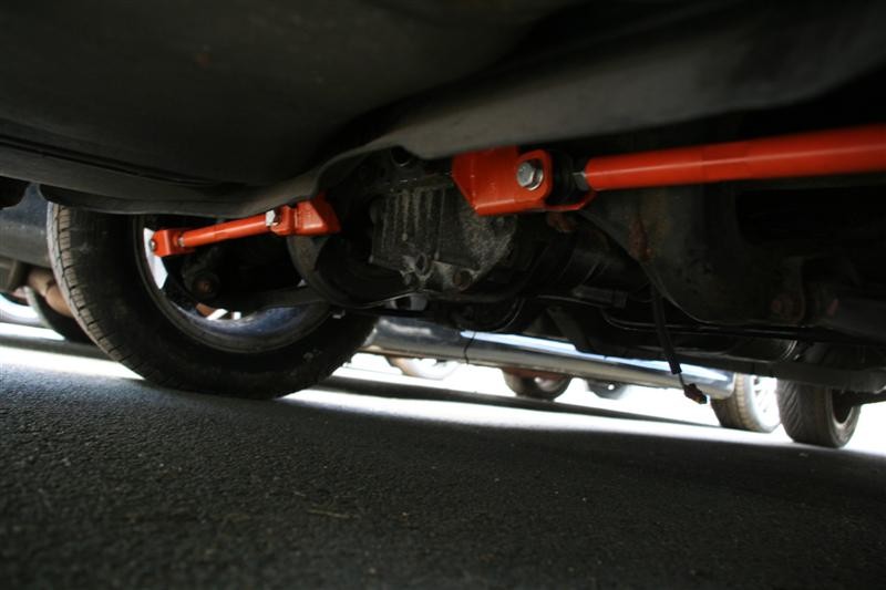

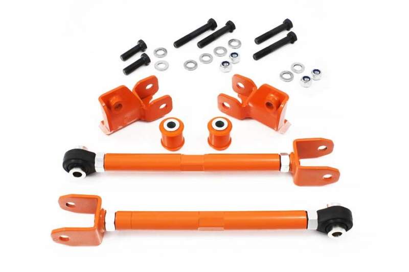

No modifying as such, but the outer hub bush needs removing completely from the lower arm as the Driftworks system has its own push in bushes.
(See Pic)
Jeff
(See Pic)
Jeff

Just fitting the driftworks kit and the bushes for the hub are not in 2 halves. Also the brackets mounting to subframe don't seem to be a snug fit. They seem a little sloppy.
Sent from my SM-N910F using Tapatalk
I've sussed out the subframe fixings so that now makes sense. Just the bushes in the hub. Great quality kit but a fitting diagram would be handy.
The two piece bushes must of been changed, no worries warm them in hot water and press in with a G clamp and washing up liquid.
Jeff
All done now. Unfortunately I cut one in half to fit, thinking that they must have supplied the wrong ones. Then lubed other side with fairly liquid and it fell in. So I will order a new bush for the other side. Your method of heating the housing on the hub worked an absolute treat. Thanks for all your help Jeff.
