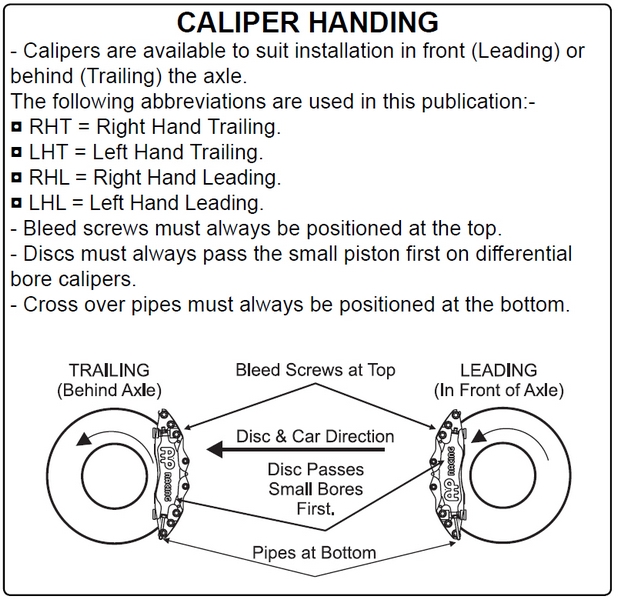

So, I couldn't wait till next week, I've brought my Brembo's into work and have one of the lads helping me. :innocent: Having looked at the calipers, I want to know which way I should have them ie. Bleed nipples to the top or bottom of the caliper, Larger piston to the top or bottom or does it matter which way round the pistons are ??
Allthough this is for AP calipers the information you requested is the same. Leading caliper configuration - larger bore at bottom. Nipples up.

[ATTACH=CONFIG]92353[/ATTACH]
Thanks for that Andrew:thumbup: Well it looks as if I'm going to have to split these freshly powdercoated calipers, because, Guess What?? Some Ape has put them back together the wrong way already!!!:cursing: I was trying to work it out off Andrews Diagram and have just copped that I have a small piston lined up with a large piston!! So these have been split and put back ARSEWAYS!! I've two choices now, Get the old set (Donor set) powdercoated and rebuild them as they've not been split or split the newly powdercoated ones and switch around the sides changing the o rings also.:thumbdown:
