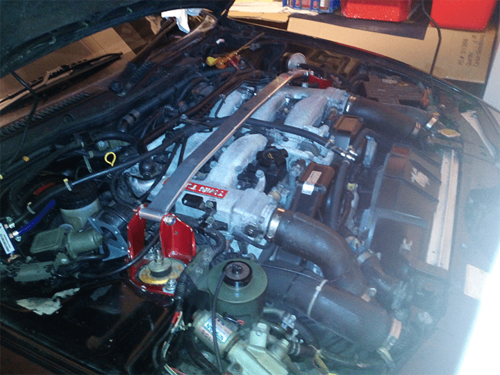

So today I fitted this strut brace (from Mondo's car) and I just need some advice on where stuff should go. Sorry if they are obvious, I am noob.
The first thing is that the throttle linkage (I think) in this picture, I had to unscrew to make space for the mount.
The second thing is that on the other off side tower there are lots of cables etc. The thick cable in the picture below stops the bonnet from shutting and is connected to a metal pipe. Once again where and how do I move this please.
Final thing is that how tight should I make the bolt which connect s the mount to the bar. I did it tight but not overly tight. Where on the towers I did pretty much as tight as I could.
The throttle cable runs through the mount on the driver's side - there are two round holes in the sides of the towers, and the cable fits through that so you'll need to disconnect it under your throttle cover to run it through.
For the passenger side, I only had to run the pipe coming directly off the fuel filter through the holes in that tower.
Oh okay, I didn't see the significance of those holes until now. Thanks si

Oh but the throttle mount thing won't bolt back in place because the strut tower is in the way.

The cruise control? The round-ish black thing? Mine doesn't have that so I can't help with that issue.
It's a reasonably common strut brace though, so someone on here should be able to help :)
Iv got that brace pull the petrol fuse out start the car too loose the pressure from that hose look at your strut there 2 holes put the hose though them and back on the pipe for the the othere part you need a extension as it need too move over I'll see if I still got it on mine as mine now a man and if it's there you can have it

I had to unbolt it to get the strut bar it, but the metal bracket it sits on interferes with the strut. do i need to get a new bracket or did most people with this mount just delete it?

First part agree :) second part, as its not a show car anytime soon i will probably cut another sheet metal bracket and keep the cruise control.

Anyway, done the cruise control bracket, now i just need to put the fuel hose lines through it... without spilling the tank on the floor :')

So did these hoses and all complete, bonnet now shutting, everything in place.
only bad thing was that when taking the return hose out... the petrol decided it was going to stay in there and drool over the floor.
Result, puddle of petrol on the garage floor, which doesn't belong to me.
