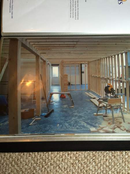

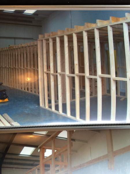

here is some studding i did in 4x2 its just a better job stronger and you can fit 4inch insulation in it to IMG_3658.jpg

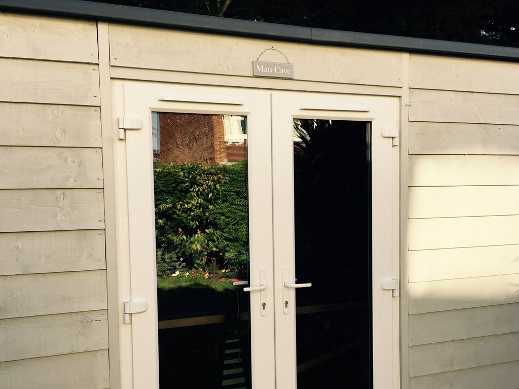

Built from 3x2 stud work at 400 centres with noggins at 1200, clad in rebated feather edge board. 7x2 rafters with OSB and Fibreglass roof. Pre loved French doors of a friend, and sign courtesy of an appreciative relative.

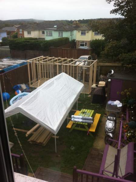

Timber arrived at midday yesterday and knocked this up in about 4 hours, go to do the noggins and cut and frame where the windows are going, picked up the sheets of ply for the roof today along with some double glazed window units and have covered it all up for the night with a huge tarpaulin as its meant to rain through the night, the tarp is so big i can work under it like a tent.
Its 17ft x 8ft, 2m at the rear and 2.3m at the front elevation as im keeping it under 2.5m for permitted development
