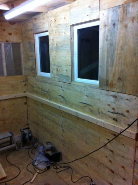

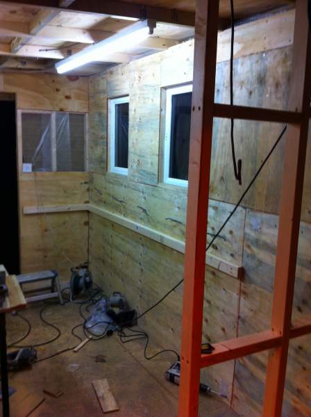

Got a bit more done over the last few days, running 2.5 twin and earth for power sockets, 1.5 twin and earth for lighting, ran some temporary power from an extension at the minute until i run some armored cabled in permanently, mainly so i had some light and could carry on inside when it gets dark.
Started boarding the inside, 12mm ply so i can screw shelves or anything anywhere and also adds even more stability, solid as a rock.
Still to felt the roof, im waiting on a good dry day before i even attempt to remove the tarp :biggrin:

Yes nearly finished the inside, still have to felt the roof, but weather being crap over the past few months the tarp is doing its job at the minute.
Got the whole inside boarded and painted white and sealed all joints with sealant, worktop in, electric, a shelf over the worktop with led strip. Two 5ft tubes in both ends of the workshop, an oil filled radiator and interlocking rubber flooring (like a jigsaw puzzle) from Halfords gives it a nice cosy feel under foot. A little stereo system, loads of twin sockets, one with usb charger points in.
RCD garage unit for protection and wired into the house to the cooker feed, so have about 30amp supply also protected.
I just have a few bits to finish off before i get everything in that i want and start using it properly.
Will take a few more pics over the weekend to update :thumbup:
