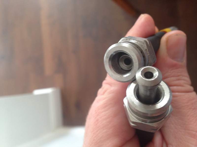

I bought the attached from a vender in the UK. I believe there to be an issue with them. Fittings from the hard lines and the lines on the body are of a male chamfer (both) meaning that the SS lines should both have female chamfers on them enabling them to locate and centre before being screwed in.
The issue I have is that the lines I have been sent have BOTH on them, ie one male chamfer and one female chamfer. Of course having a male chamfer butted up against another make chamfer would mean that the ends would not align, even when screwed in together.

Si. In your picture.....
Top one is WRONG
Bottom one is CORRECT.
Top one is WRONG

Thanks Pete! I just realised I'd gotten it the wrong way round when I pulled out my new OEM hard lines from the box.

"Nothing wrong with that at all. Ours is dual seating meaning it seals on any opposing seat. Used this for over 7 years worldwide without any issue on all our kits"
Guess it's good to go then!
I can see from the picture what they mean.... but I personally dont see why they cant just make them with two the same in non universal form.

They don't. Having said that, when you place the ends of the stock lines next to the ends of the HEL lines, they don't interlock. It's quite strange. But if that's how they intended it to work, then I guess I'd better just fit them!

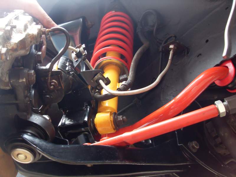

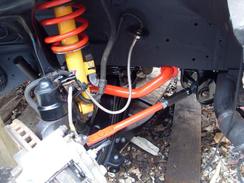

i have them i fitted on my car and they fit there hel seen pics SDC12492.jpg
Si, the hel kits all run this end fitting and for the 300 they aren't designed to fit to the caliper, hard line remains. I was lucky that I could make my own up and run straight to the caliper!
