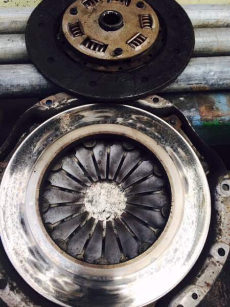

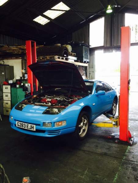

Do doing another one of them jobs I hate doing on a zed:(,replacing the clutch because I noticed when on the last track day the gears got harder to get,so stripped the box of this morning to find this!
Doesn't look to healthy does it? Some of the friction pads have come away! And really worn flywheel and pressure plate.
Noticed the crank seals gone as well so ordered one for tomorrow,thinking of it on doing this job should change this anyway,so we'll have to finish it tomorrow now:(

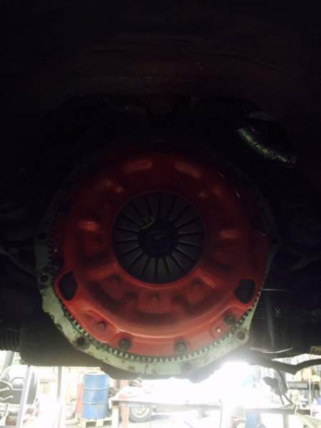

I've dropped my gearbox to try and diagnose a problem with it not disengaging, and annoyingly, there doesnt appear to be anything obviously wrong!
Dropping the transmission is only a couple of hour job once the car us up on stands, but still a bugger!
Going to try an upgraded clutch fork even though the original one seems to look OK, apparently they do flex slightly and the cast iron ones are supposed to eliminate any flex.
