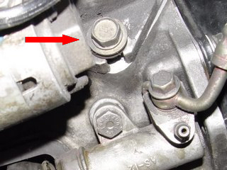

This one. It is often stripped by over tightening allowing the starter motor to pull away from the flywheel ring gear.
[ATTACH=CONFIG]89727[/ATTACH]
That's the little bugger
it is usually when the starter fails to engage properly and the teeth on the flywheel don't engage properly with the starters drive......

I would check the bolts Si, if you leave it your starter is likely to come away from the car ????.
They are easy enough to get to when I checked mine the second bolt was hanging on by a couple of threads and the lower one had gone all together, ive no idea how it was still engaging the flywheel but was making an aweful noise.
