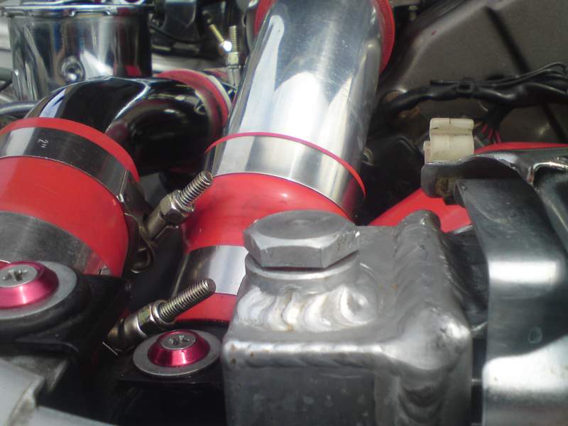

Vent screw koyo rad
Where can I get one? Mine was plastic but either a plastic or aluminium one will do. It's the one from the top left of the rad. Even looked on ebay and can't even find any on there.
I could do with one as well. I took my now misplaced blank off to fit a stat that i no longer use, would like to remove this as it'll then look a bit tidier.

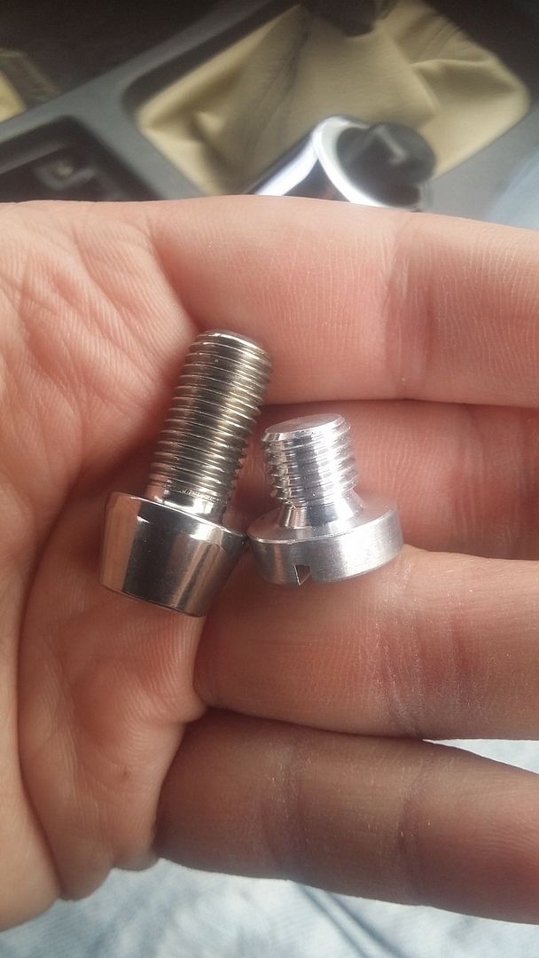

The picture shows the size and thread needed (M10 x 1.25). The bolt on the right is titanium which will not react
with the aluminium (unlike steel). Something like this would do the job:

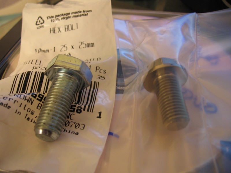

Paul, wait til I get home mate as I may well have a bolt the right size somewhere as I bought a couple for mine previously.

I have a present for you. It's the right size (longer than the standard KOYO one though
Picture with the one in my rad:

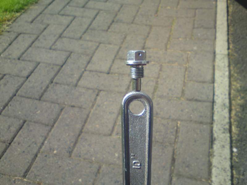

A further update here, before i found my original one in the post above, i already had ordered a plug bolt and just to confirm again for my rad it was M12 with 1.25 pitch thread, this said bolt arrived today.
Cannot see a reason why it cannot be magnetic :cool:.
This is the one i am going to use, just for the simple reason it's new and the original one was showing it's age with burred edges :thumbdown:.
