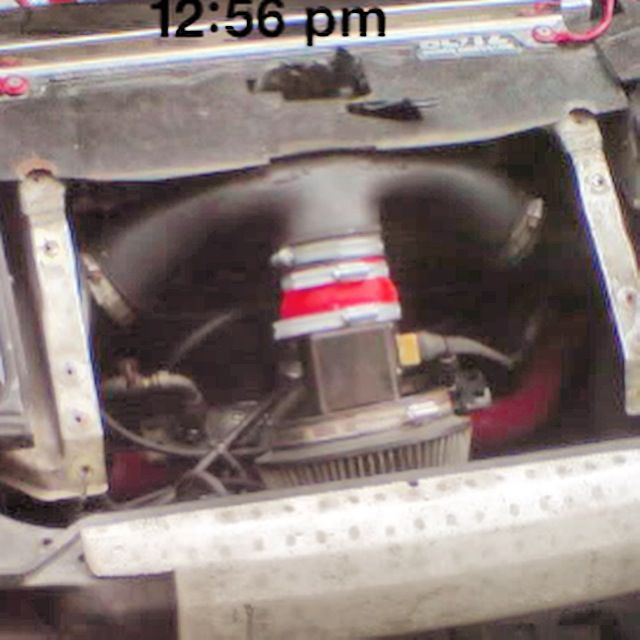

I have a Q45 maf intake setup do I need dual?
I currently have a Q45 maf setup which seems very reliable. But is it restricting possible HP as opposed to having a dual maf setup?
Question is, do I need a dual intake setup or is the current good enough for my setup?

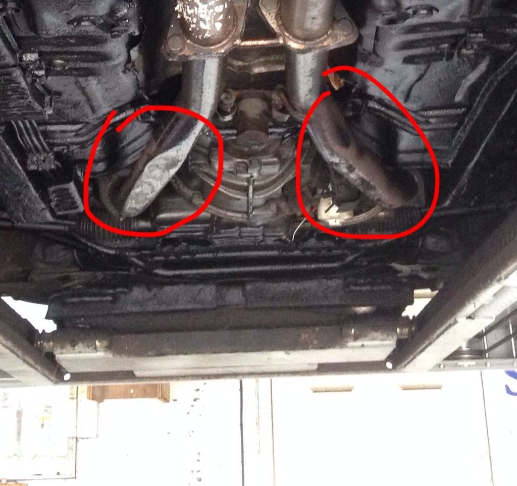

2.5inch full de at exhaust (currently squished a little and has the remains of a plastic bag stuff to it see pic below.....oops)
Surely this isn't good for performance?

From what I've read, the dual intake will always offer better performance than a single as it removes the restriction that is the T-piece that your MAF is connected to.

Your larger MAF intake goes straight into a reducer back into the stock pipe work. Maybe you could try your setup into a planer and 2.5" intake kit?
Or maybe have someone make a larger bored T pipe to fit the maf without a reducer?

Have you considered upgrading ALL the intake pipework to a larger diameter?
I'm sure q45 limits are on the forum somewhere, but since a single stock mag goes to just under 600 it should be ok depending on your goals.
Going to a twin setup will be more efficient from an airflow perspective, probably not noticeable unless you also upgrade all the intake piping too
As said, you've got that big old maf followed by a bottle neck. It's probably no more effecientcy than stock. Your only as strong as the weakest link etc, which you've retained. I recon you'd gain more from 2.5" intercooler piping than going 2.5" to 3" on the exhaust, that said that flat spot can't be helpful.
