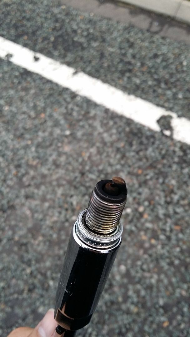

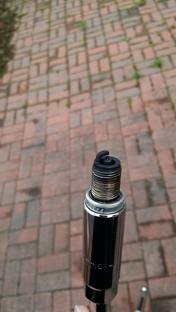

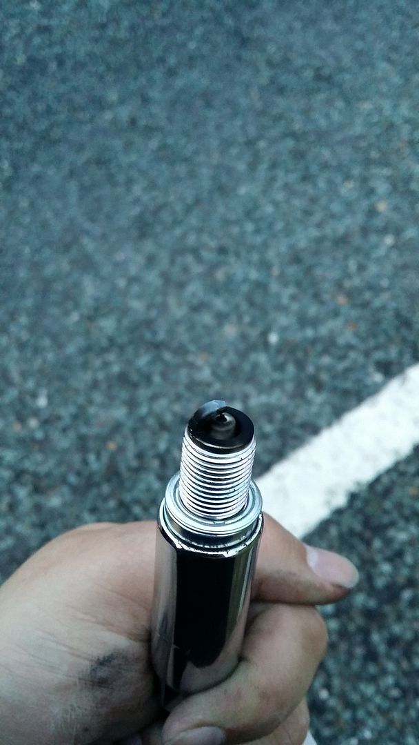

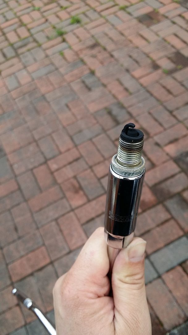

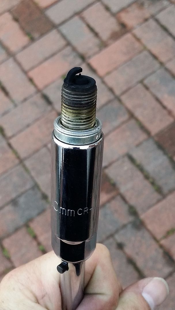

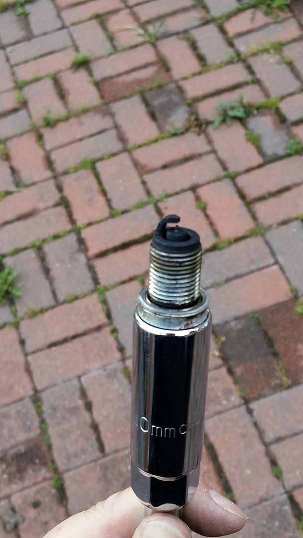

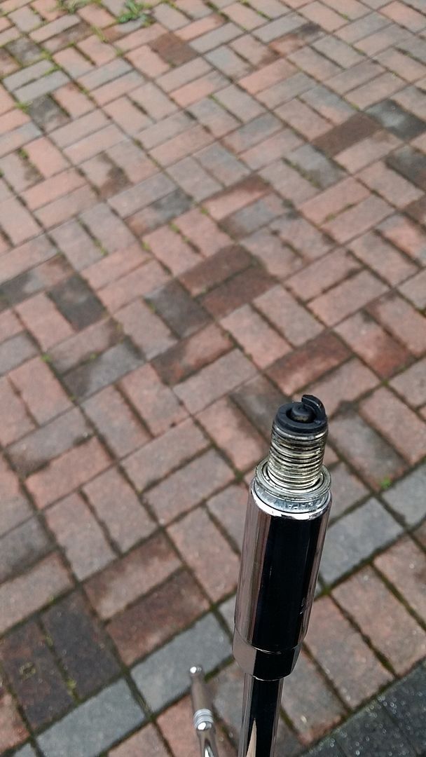

So, after getting the fuel pump sorted, the car started but ran was horribly mis-firing. So I decided to take all the plugs out to have a look, as they were all black I changed them and put in some old ones that were fine when o took them out.
Here the photos of the plugs when they came out
Cylinder 1
Cylinder 2
Cylinder 3
Cylinder 4
Cylinder 5
Cylinder 6

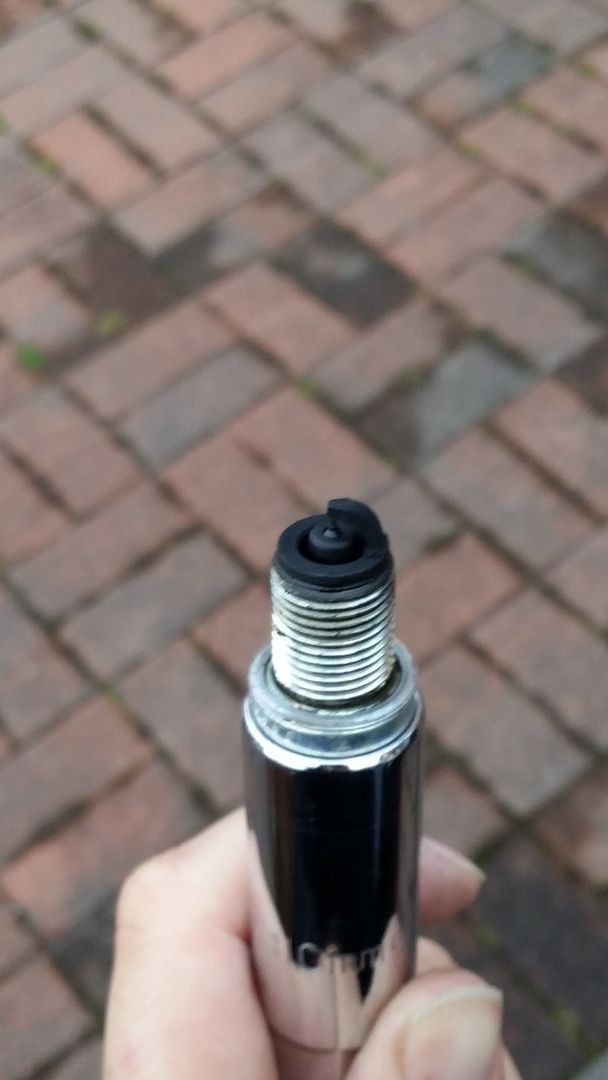

When I change the above plugs, the car started and seemed perfect. Do, I took it for a drive and... Broke down again. Had a look at the new plugs that were put in to see what they were like and:
Cylinder 1
Cylinder 6 (which was a brand new plug)

Jimmer said from looking at the photos it looked like u burnt fuel.
So to get home, I unplugged the MAF and, it fired up and limped me home.
This seems to me like it's either a fuel pump issue or perhaps something electrical not working. Any ideas?

Unburnt fuel?
The first set of plugs are completely ruined from fuel, but given that the outlet hose from the pump had come loose, it's difficult to see how that has happened.
Is there anyone nearby that can check it over to ensure everything is fitted & connected properly?
