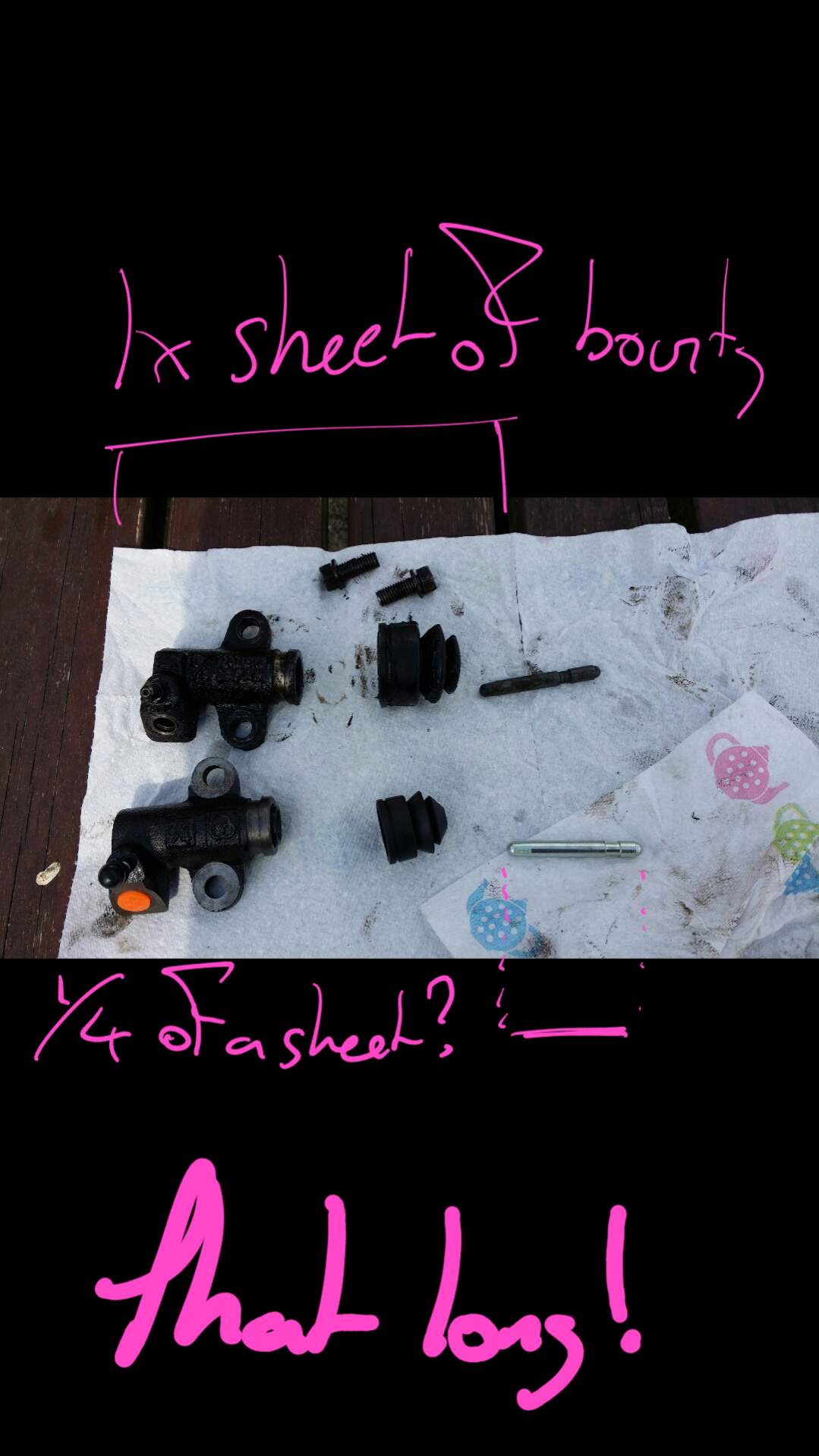

While I'm waiting to get the car to Jimmer I'm sorting some issues while I can. The clutch is slipping but I know the clutch is good, think the problem is the rod from the slave cylinder to the fork on the box was missing so I made one up best I could. So if that is too long could that be the cause? If so does anyone know the correct length of it?

Anything else to scale it to? You're a bit greedy as you have two of them.. Lol
Give me till tomorrow night and I'll take mine out and put a pic up and measure for you, please bump this tomorrow tea time as I'll forget lol
Good point, one was knackered but that was a seal in the cylinder not the rod. If I still have it I will send it to you mate but I really can't remember what happened to it. I will let you know either way tomorrow. :thumbup1:

Do you want me to measure for you bud?
Yes please, mine is 82 mm but someone else has said it should be 65mm ?
Here we are........not a Nissan slave cylinder but the replacement brand whatever it is did the business for a dew years on my last car.
Thanks, trimmed mine to 65mm but still slipping! The clutch that went in was good, the slip is less after trimming down, with pedal adjustment should it be closer to the to i.e. Undo the thread switches so they come almost out or is it screw them right in to lower the switch? I've done mine out wards
