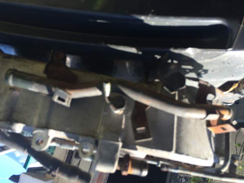

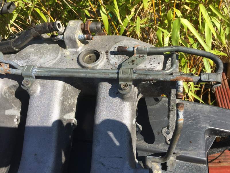

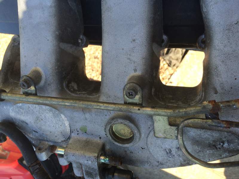

Club member no. 779:thumbup1:
Remove those pipes and do a throttle body bypass, when you put it back in the car, remove the PCV valves and i would remove all brackets, if getting powder coated or not, you want a completely bare plenum to get the best results.

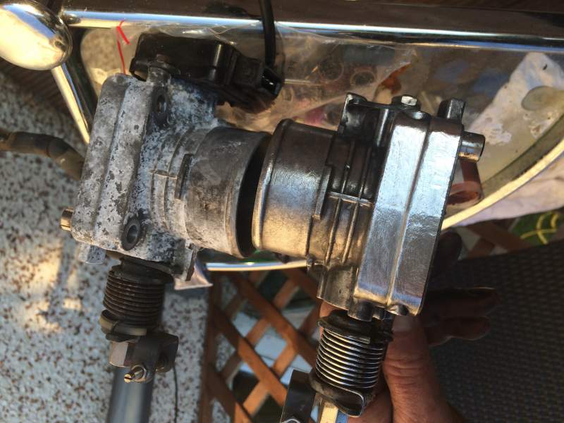

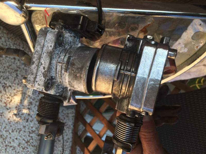

The powder coaters said that they'll do the prep work to include smoothing the castings, they've been told that I want a smooth shiny finish, which they promised to do, so it's down to them, I told them I had a couple of guys in work that would prep them and they said they'd rather do it themselves. Can I get the throttle bodies powder coated also?? I've removed everything off them also but there is a little plastic ring that kind of protects the bar to stop metal hitting metal, does that matter??

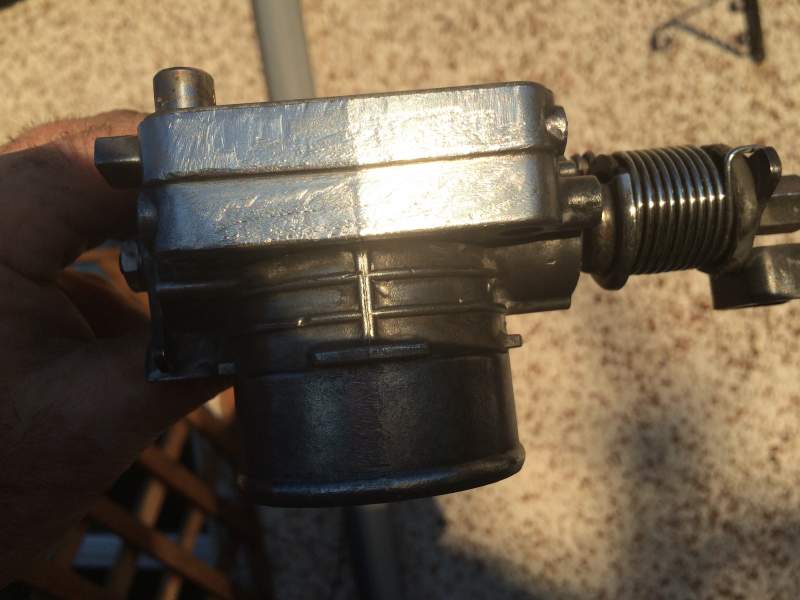

I had a go at them with the Dremel this evening..
Not too bad for a first time effort :thumbup1:
Undo the two screws on the butterfly in the throttle body and the bar will slide out :thumbup1:

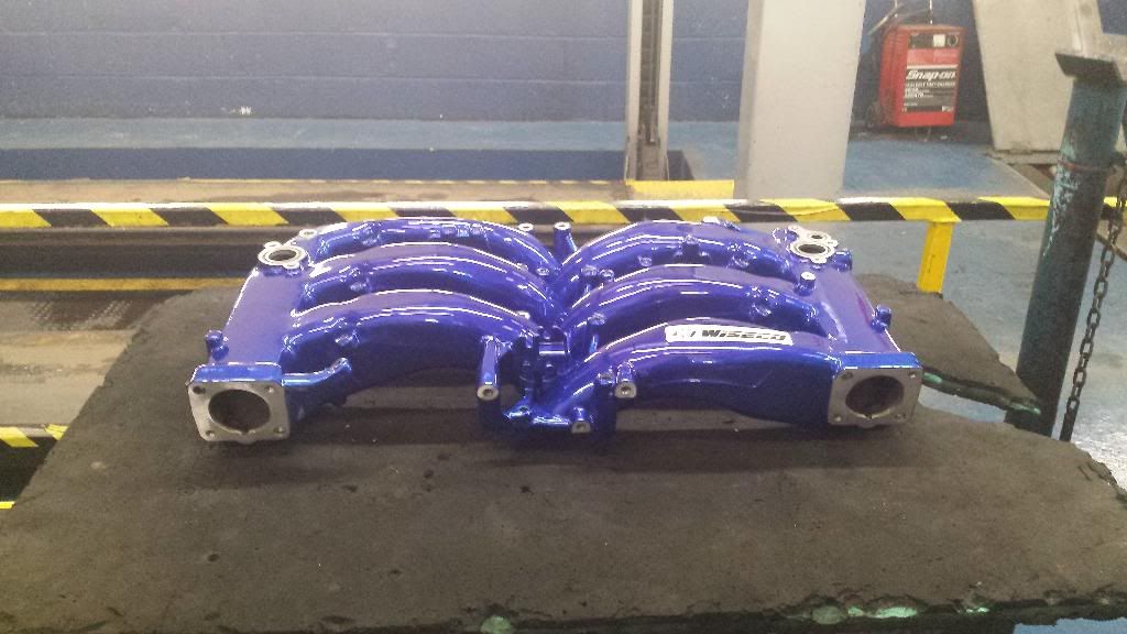

This is mine I didn't smooth mine and it has covered all the marks it's smooth like car paint, but 1st powder coater was crap think it depends who is doing it, mine was done twice 2nd time it's on a lot thicker and covered everything mine is candy blue it has a chrome layer then blue by the looks of it,
Put an old set of pcv valves in the holes,
Some m6 and sure it was m8 in the other bigger holes,
I didnt mask the gasket faces and I used a da sander keeping it flat and removed powder coat on faces and mine has been fine no boost leaks etc...
I also made some egr blanks from a piece of stainless sheet.
here's a couple of pics of mine
Thanks for the pics Terry, that looks really well!:thumbup: did you powdercoat your throttle bodies and water pipes in silver or have them polished??
I just quickly polished them on a desk type polishing thing my boss had at work,
again there not polished like a mirror but are shiny and probably how they were when new
Had 2 plenums in garden and they were really crap looking the throttle bodies were rough like this but came up well, also they blast the plenum before coating which probably evens out a lot before coats go on,
Sorry water pipes were powder coat chrome and again I have 1st set in garage they came out horrible but the 2nd lot are very nearly chrome but easy to clean,
If the powder coater is good he can hide all the slight marks,
