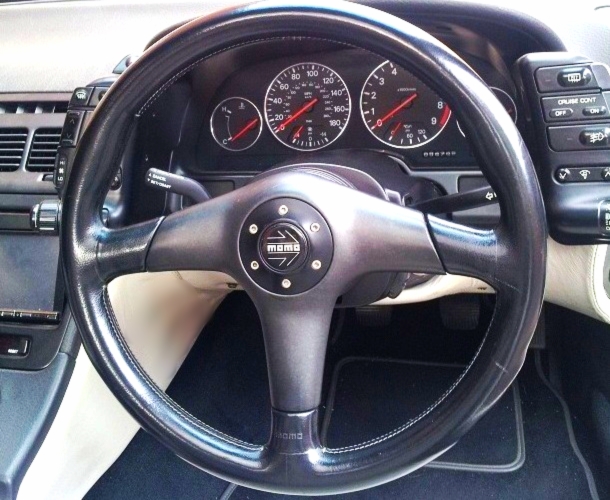

Perhaps yours is different, but some have cruise control on the sidepods:
Mine doesn't have cruise control at all so the slot just has a placeholder.
Yeah, that switch is what turns the cruise control on or off in the first place, and you then control it with the buttons on the wheel.

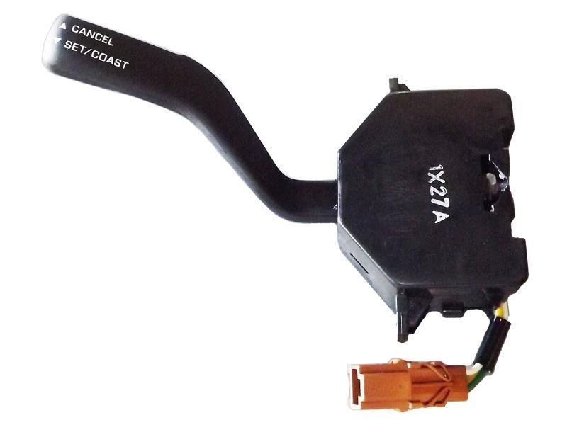

Almost! My car came with a Momo Race wheel on it when I bought it....but it had cruise control. I fitted another more 'fitting' steering wheel and wanted to re-instate the wheel. I had the CC buttons plugged in, so knew it all worked, just couldn't find a decent location for them anywhere.
I'd been bugging the guys at Z1 to send me a cruise control stalk from a late spec version that would have come with airbags from a JDM RHD front clip that they may have, but they never had any spare until out of the blue Jon called me and said he'd now got brand new ones in stock - WHERE DO I SEND MONIES.....and this arrived! :)
Tried it for 'fit'.

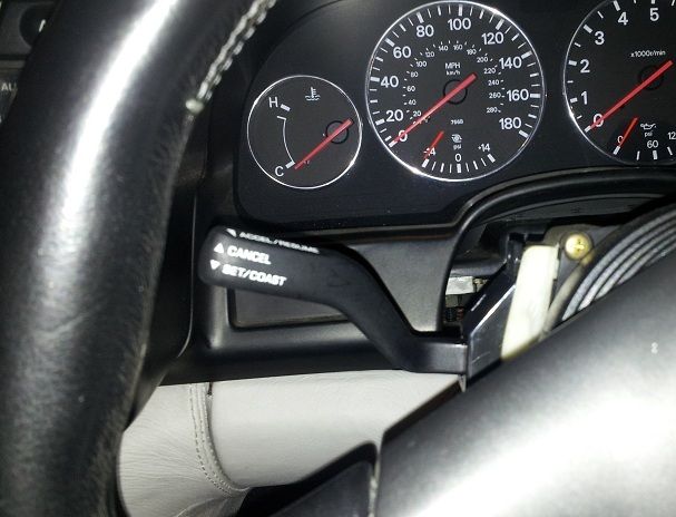

The carefully modified the steering column shroud (as later ones don't fit) and I have a factory look. :)
Here it is with my old steering wheel.

Does it have to be a late spec car for that to fit?
Nope. Mine is a 91. The bracket is there already and the unit slots right in. You'll need 4 screws like the ones that hold the indicator stalk into its bracket.
Then of course there's the wiring as it's not plug and play.
Easy then, cheers. Saves me buying the wheel buttons and finding somewhere for them to go if there's a stalk available anyway. :)
