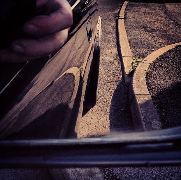

It's not the best pic in the world to give you an idea of a +20 offset on 9.5J's up front, but you get the idea
