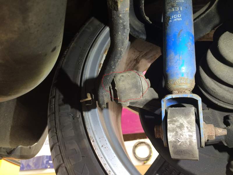

What is this part?
Car had an MOT today, as usual the guy was amazed at the cars condition, well except for this:-
The part circled in red is worn, so need to order a replacement.
What part is it?
You can see it wobbling about when you move the wheel mate.

Yup, that's your HICAS outer joint. It's pressed into the rear knuckle, so you'll need to take the whole assembly out for it to be put in a press. There's also a seal cover on the back end (you might be able to reuse them). They are a genuine Nissan-only part. If your hex nut gets damaged on removal, then you'll need to order that separately as this is not supplied with the ball joint itself.
