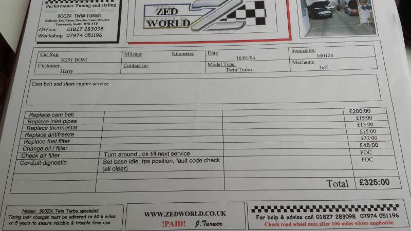

Checked the history file of K291BOM and the last belt was put on by Jeff at Zed World on the 16/01/04 with 45000 miles it now has 65000 miles.So 20000 miles and 11 years later it is having its third belt.
[ATTACH=CONFIG]87374[/ATTACH
