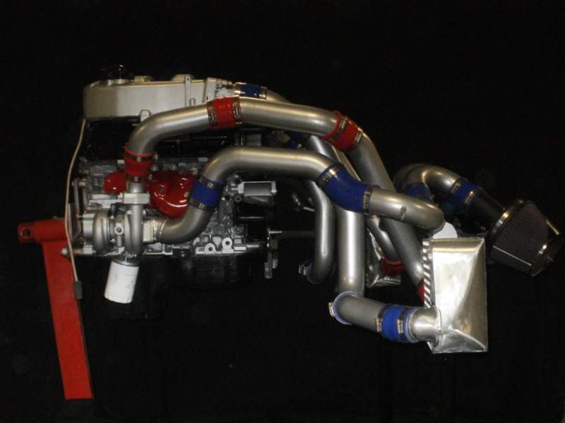

Is there a blown up diagram somewhere that shows the route of boost?

Although these photos are for the AshSpec pipes, the inlet routes remains the same as stock. Exhaust paths from turbines and
out to the back of the car don't crossover, but may be linked (depending on manufacturer) by H or X pipes linking both banks.
^^^ That just looks sooo complicated!!
