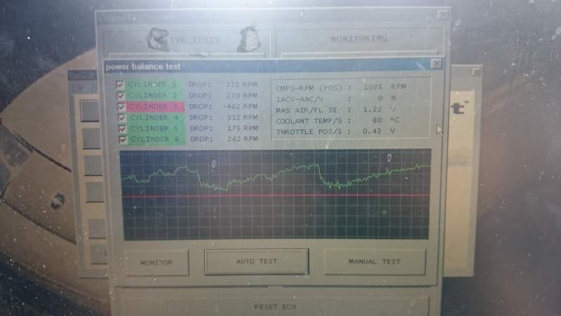

Started her up today ready to get her back on the road and she's hunting again, no split intercooler this time seems to be no vac leaks either.
Conzult shows no error codes but on power balance test I have - 462 on rpm?
Smells really bad too at the moment but no answer excess smoke?

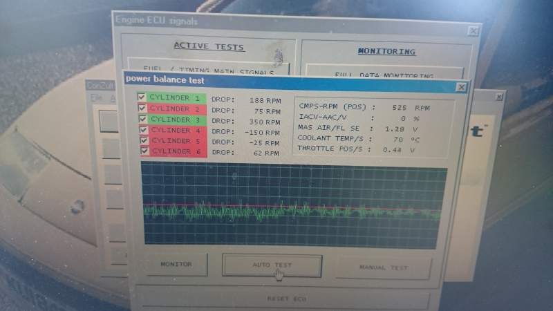

Just swapped coil pack 3 to 1 got this...
Idling differently no smell though, weird...
Sounds like an injector out, do an ohms test on that injector, check for corrosion on terminals on the injector and plug end.
Turned it on and off again now it's running fine, found one dodgy pipe that has split.
Will check injectors now
Idles like a champ but the power balance still looks dodgy, if it goes through the MOT I think la autos will be getting a visit
