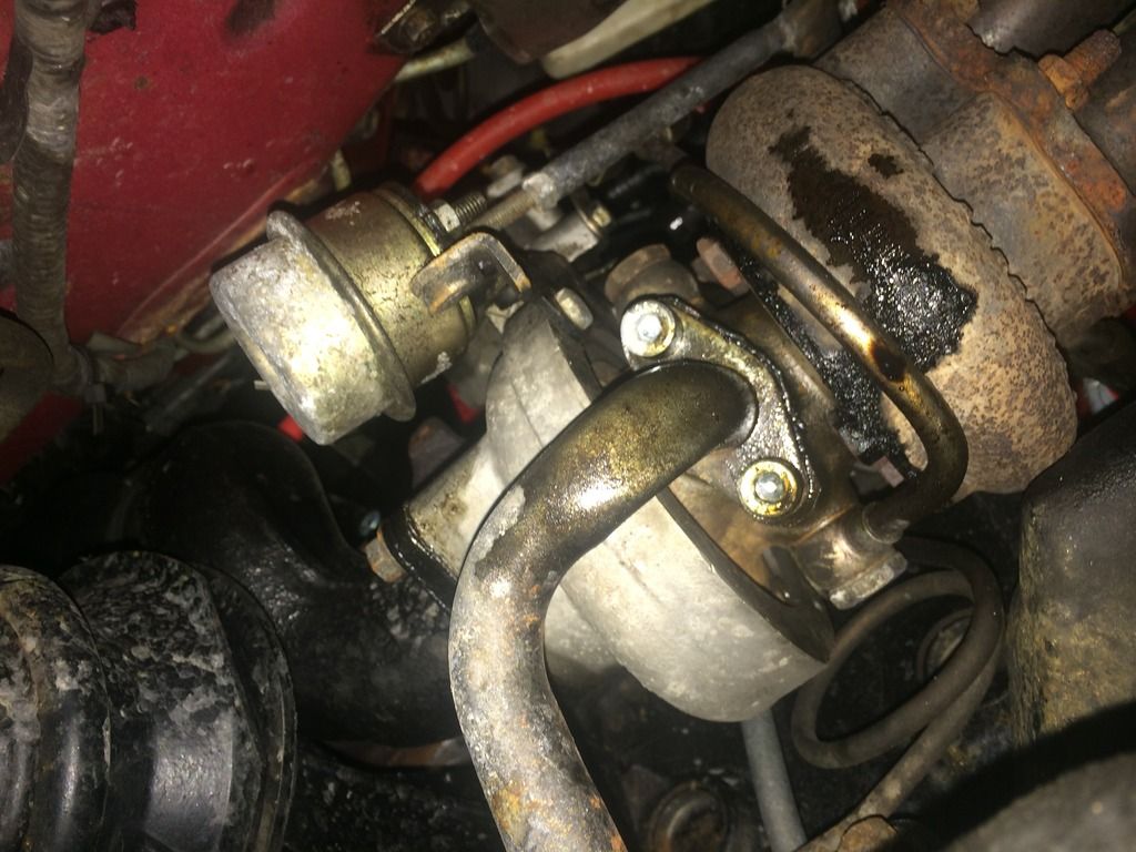

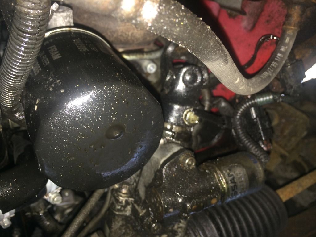

So i moved house a month ago and the car started misfiring which was a last drop for me. And since i dont live on a 3rd floor anymore and i have a driveway i got a hold of car ramps. What i found left me shocked.
Those are both turbos with oil all over them.
And that is the actual zed and its heart. Devil in disguise.

Get yourself a compression test done. That's exactly how my rebuilt turbos now look after a cylinder died last summer. Excessive crank case pressure stops the turbos draining properly and it bleeds out the real seal into the exhaust housing, on overrun where there is lots of crank case pressure you loose more oil and it pools out the core like that. I believe that's what mine are doing anyway as as long as you don't let the car over run it doesn't smoke. Turbo real seal failure is typically light grey smoke that wafts at idle or billows out as you pull away after prolonged idle. If it's blue smoke then it's likely ingested oil that has been combusted, either from it being sucked into the cylinder, Pcv and blow by etc.
Second hand motors are always a gamble, a great looking block may have been sat on the shelf for 3 years to run great for ten minutes then start failing. Conversely they can be a great solution if a rebuild isn't financially feasible. Rebuilt turbos are always a bit hot and miss, failure rates are quite high sadly. The quality of the rebuild preformed and the subsequent rebalancing have a big impact on that. If they were rebuilt by turbo technics though you would assume it was done to a fair standard.
My money is on excessive blow caused by low compression.
Oh and btw it will almost certainly be quicker to pull the engine and you will get a better job in the end. Unless you've simplified the bay ALOT pulling the tubs in situe is a notorious pita.
