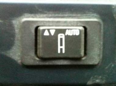

Hi I am new to the 300 zx , ive got a tt automatic one with a switch under the steering column saying auto sith like a shocker pic on it and ↑↓ on it ,what dose this do?
You've not given us much to go on, but if the car is an import then it could be fog lights.

In which case it would be for operating a parking mast (visual aid) fitted to the n/s front bumper. They were available
as a Nissan option for JDM cars. Item 1 in picture.

I reckon you've answered his question there :)
ahh sorry for not replying , but yes that has answered 2 questions in one :biggrin:
