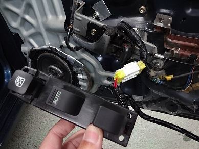

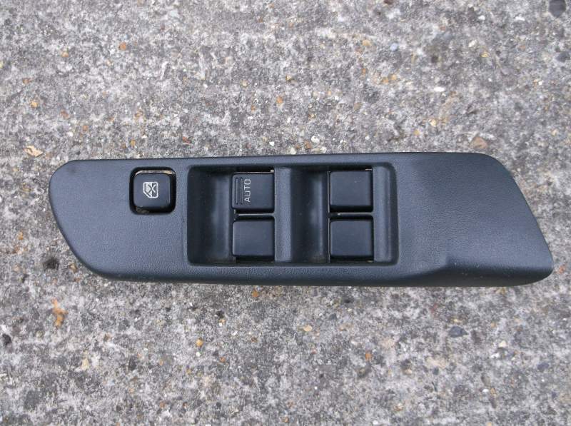

I've been looking through various Nissan and Infiniti interiors. This was actually prompted my a friend of mine in Los Angeles. I came across the e/w switches from the P11 Primera which are identical. (See both photos.)
I don't know what the situation is with the wiring, but I am sure they can be modified to fit physically and electronically. I believe these are already pre-illuminated too. The bases would need to be split, hopefully that split chassis would mount up beneath a stock Z32 finishers. Z32-Zone do an adaptor harness, but not entirely sure whether some loom from a Primera can be spliced into the existing harness in the doors.
Just some thoughts for those that might want to try it....myself included!
The issue would be the finisher....whether that could be modified...

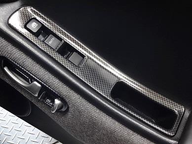

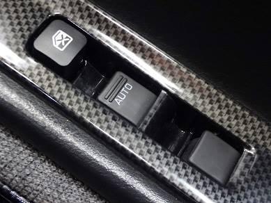

I kind of like the idea of being different with these - but - I'm not convinced they look better than the earlier stock ones. Look close the the 99 spec though

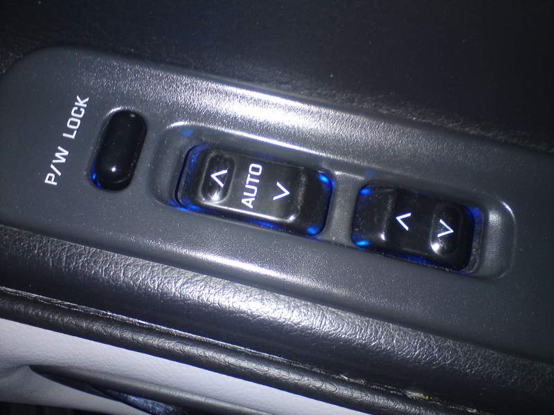

Hi Ted I like the look of that!
Hows it wired & method?

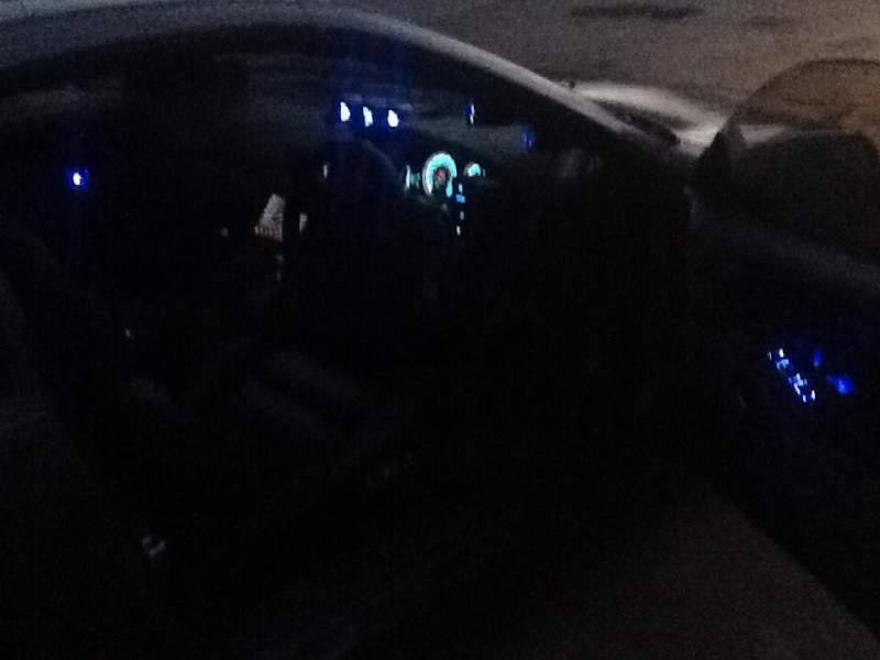

Groover the lad that did mine for me

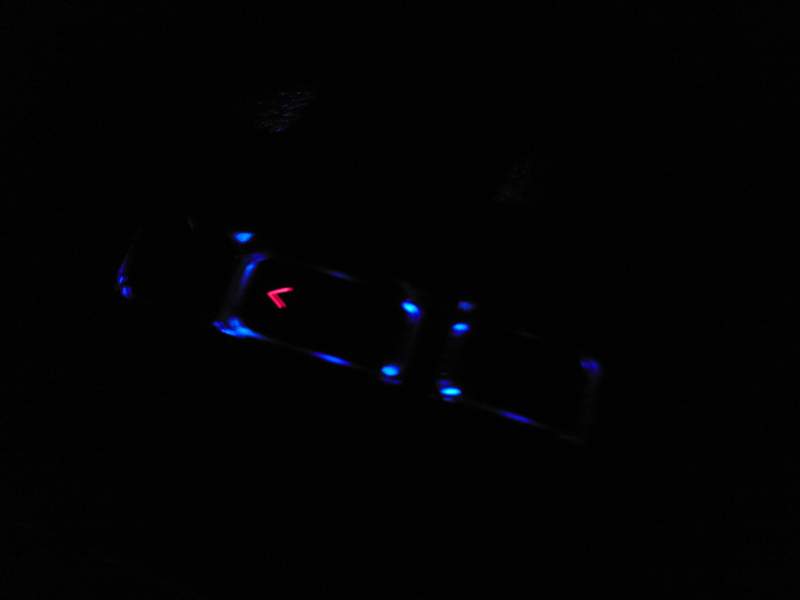

I have to agree with Lee in post 2, when you get one without any wear and back light it, then get the bulb working for the red in my case's arrow, don't think it can be beat imo.
Ok, how did you get the arrow to light up...?!
There's a stock bulb holder for it and that alone, so on the loom there's a 'lights on' feed and it's on this the blue back light strip is spliced.
I am aware that not all switch assemblies have the bulb holder, so yours may be one of these ?
Just like to add that it is only red because i have used a red led bulb, originally it would of been clear with perhaps a green rubber johnny on it !!
Think it's one of those wedge T5 bulbs from memory - like the ones in the pods.

The series 2 switches iirc have the illumination, standard though you would hardly notice it, its not until you stick an led in there it really pops :thumbup:
Also having had some experience with the 99 spec switches, its not just a case of plug and play:nono: you will need a couple of relays and change the wiring slightly on the supplied loom for it to work, i have a pic and diagram that Jeff sent me after he worked it out.
