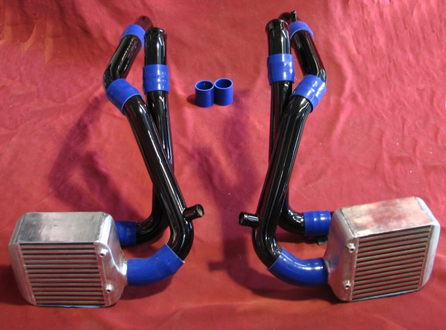

Note that this guy has got confused with pipe routing....
As it should be:
This picture really higlights the ridiculous length of pipework and associated pressure drop that the turbos are required to work harder in order to overcome. Grim :laugh:
Compared to....
The TDM FMIC above is exactly how I've been running my set up for 18 moths, albeit with pipework that is not ideal as it was completed from start to finish in a single day (big up the Silverline).
With any FMIC and short dual intake, you can immediately halve the turbo inlet tract.
A proper FMIC set up will always be preferable to a SMIC setup. It's well known with every other performance vehicle, the Zed is no exception. By "proper FMIC set up", I mean similar to the TDM item, with air filters situated down where the SMIC reside with no 90° bends under the headlights. Simply not possible with SMIC, no matter how "B.A." :wack:
Rather than build a custom set up, people just make do with eBay items and stock 2" IC pipework. Only in this situation would a massive pair of SMIC with the 2.5" pipework be preferable.
