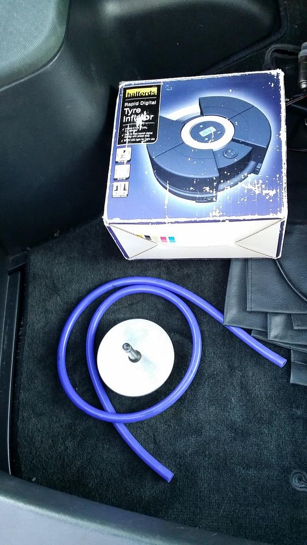

So decided I would do a boost leak check today. The tools I was using are below:
1 vac/boost leak plug
1 piece of blue tubing as I have loads sitting about in the shed and its great for hearing small leaks.
1 halfrauds tyre pressure inflator thingy
Sadly, I didn't seem to be able to get any pressure in the system, nor was I able to find any leaks. Thought maybe the tyre blower upper may just not be giving enough air. So, I decided to get the smoke matches out of the boot and try again. At first, I can't see it coming out from anywhere, but then sure enough, it showed itself. Sadly it's coming from down near the drivers side turbo and I can't actually see where it's coming from due to the huge manifolds so I'm gonna have to get it up in the air at some point. On a plus point, I went round and tightened everything as a matter of course anyway.

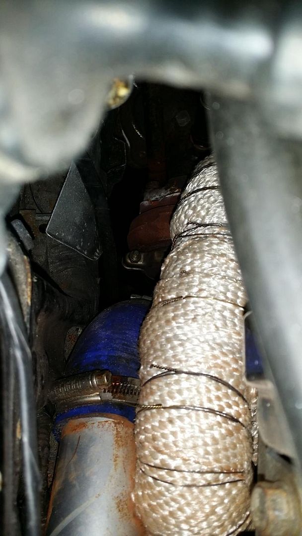

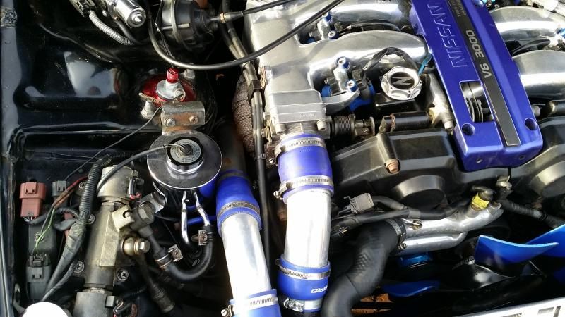

So, the leak seems to be on the drivers side turbo outlet pipe. The silicone coupler has a jubilee clip which seems to have come off the silicone bit. It's pretty impossible to get at from under the car but I can get my hand down from the top but can't get the jubilee clip back on.
I'm guessing ill have to pull the pipe off and then get the jubilee clip on the silicone before putting it back on. Just hoping ill be able to do it. Looks a bit of a pig to be honest but the only other option looks like you'd have to drop the engine down.

I dunno If you will be able to on your turbos, but I can slip my arm down by the brake master with a few things removed and do it up with a screw driver. Corse it also depends wether the person who fitted it originally though about it, and didn't go putting it backwards round the back or some annoying configuration.
Yeah. At least its not been causing any problems. Not even a rough idle or anything. I can get a spanner on to it. Just a shame its fell off the pipe really. Will try to take a photo of where it is etc to show what I'm dealing with
Membership No 0780
INSURANCE GOOFA
On the 2nd picture, you can just say see the jubilee clip next on the bottom (top in the picture) of the blue silicone thing.
I'm thinking, I'll try to undo the jubilee clip so it is fully open, then slide it back up and tighten as I'm noe convinced I'll get the silcone bit back on the turbo if I pull it off fully. Now I need to go and get a small enough spanner to fit.

Loosened all the clamps holding all the silicone pipes that goes on to the turbo. This allowed me to push the whole lot on to the turbo outlet better and in turn, get the clamp on it properly. Took the car out and it was boosting to about 14 psi which is loads better. Still stalling though when I dump the clutch after boost. I'm thinking I should really do the recircs next.
