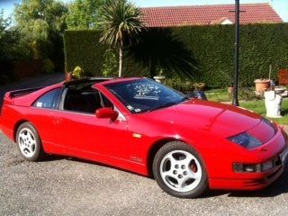

Just bought my first 300zx twin turbo manual on a J plate.
66k on the clock, wonter if anyone knows it at all good/bad :D
J555 CNC
HPI came back all clear so thats a plus
Garaged most its life so im told and that does reflect in the mileage/condition

Looks like a clean example.
Hello & welcome. You've had some nice cars according to your PhotoBucket!
P.S. Your offside alloy is on the wrong side :D

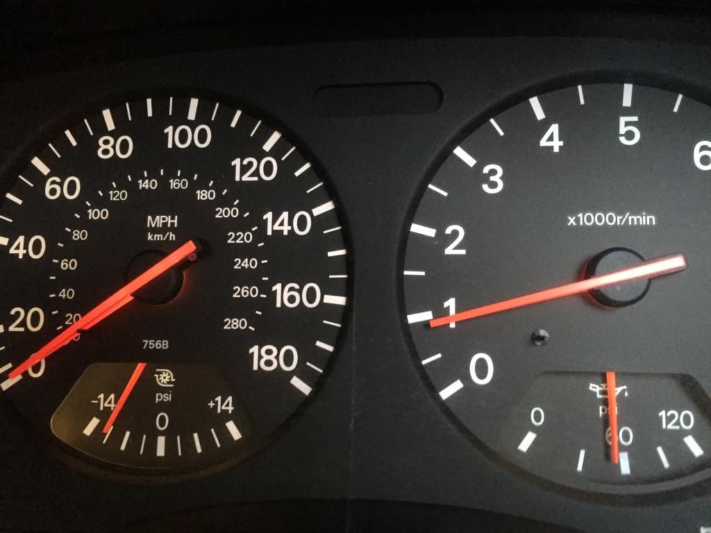

With regards to the boost needle comment, this is where it sits at, is this ok or not?
The closer it sits to the left hand end of the gauge (with the engine idling), the better. So that picture seems to be ok :)
