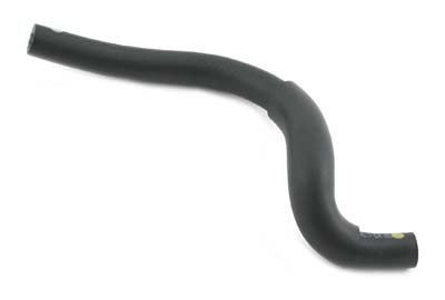

Still after this!! My clutch booster hose expired on me last year. I fitted a temporary black silicone hose, but really want the correct hose. I would purchase new, but this part is now NLS, so I am after a used one if anyone has one laying about. It must NOT either be frayed, have been cut to remove/shortened. Original in good condition only please. I don't need the clips.

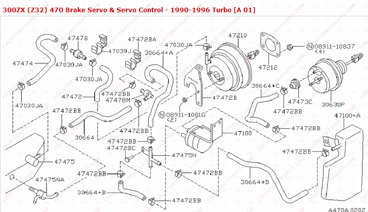

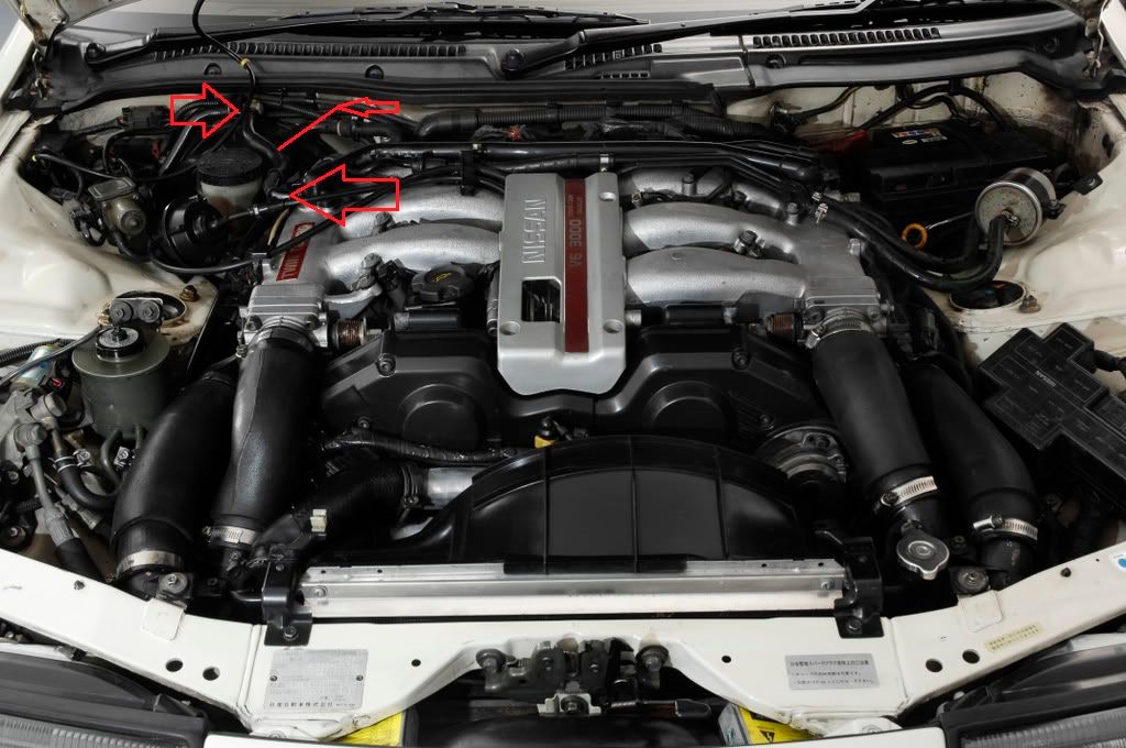

It's this the hose between the joint and the balance bar.

Thanks Lee, I have a silicone one on there now as a temp fix. It's a shitty one, I need a pre-formed one, but I'd rather stick with a stock one. They do the job perfectly.

There won't be a fluid leak, just an air leak. It takes pressure from the inlet to power the servo.

Sorry Si, I was mistaken.
The one I was thinking about was from the servo to the none return valve.
Just had a good look over it and it has deep chafing, I think that is why I must have replaced it.

RHD, I've attached the Japanese FAST section 470 which covers this part (30664) A search
gives me 30864-40P05 and the part on courtesyparts gives 30864-Z32001. Would be worth
checking with them.
It also shows up on this Japanese retail site as a cross check:
http://jp-carparts.com/nissan/partlist.php?maker=nissan&type=132&cartype=25&fig=470

Maybe it's a generic photo, as it looks like a LHD hose. Wonder why they'd have stock of it stateside? It's NLS in Japan and Europe.
Right! Time to order! Many thanks!
