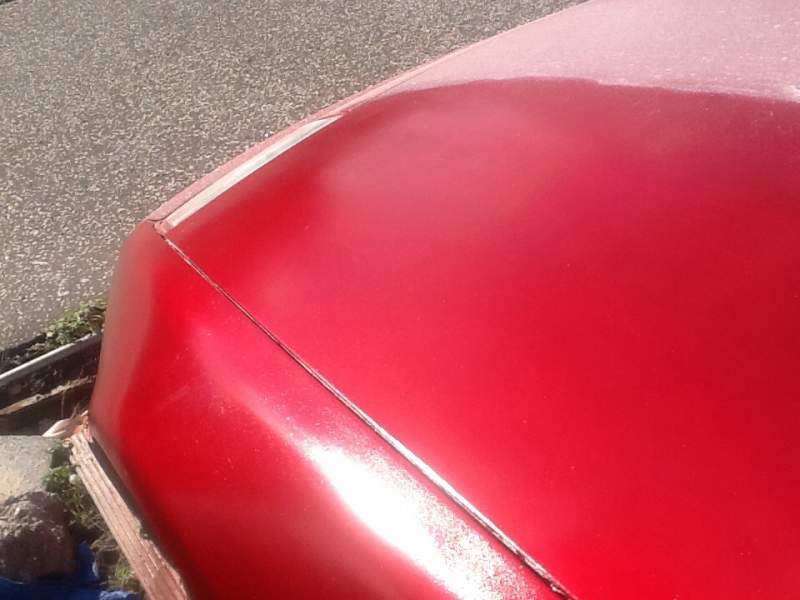

Well I'm not happy boy got too do the whole car again try'd too fix the damage and gave the whole car 2more layers now lost the pop look of the candy just looks red witch I wasn't after going too be a very exspensive month next wk when I get payd image.jpg
When heavily applied lacquer dries slowly, it has the tendency to shrink. You'll find that a good colour sanding following by a machine polish will bring back the gloss. Once that happens, you'll see any flake under that. At the moment, it'll be like looking through a mirror with condensation all over it.
It looks like it'll need one HUGE polish though!
Personally I think you've laid it on too heavily from what I've seen of your previous photos.
Edited by Funkysi
10 out 10 for effort :thumbup1: but a job like that needs to be done in a proper shop with oven, fighting a losing battle spraying a car in ye back garden

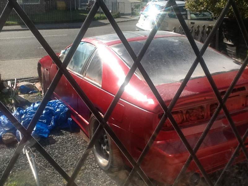

So had too walk away for a time had too think what too do sell all the stuff I got and break her or carry on but not the candy so thought f--k it in for a penny as thay say car wrap so got black/chrome looks nice but na not going too use it got too be paint so it's going too be this image.jpg Iv took the bumpers off and bonnet side skirts just the wing and doors too come off and start again
Yea already startedimage.jpg going back too bare metal
If I lived closer, I'd come and help you paint it Ted. You'd do yourself a HUGE favour if you watched some tutorials on youtube. They'll certainly help you sort your technique out.
Think your right si the technique I should have used was leave it alone in the 1st place
