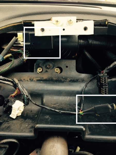

I recently purchased (from ebay) what I thought was a set of series 1 UK spec ZED World silver clocks....I have removed the original clocks and want advice on where the converter is so that I can remove it....see picture below:
Are the two items in white squares supposed to be there...or are they to do with the converter? (excuse my ignorance here!)

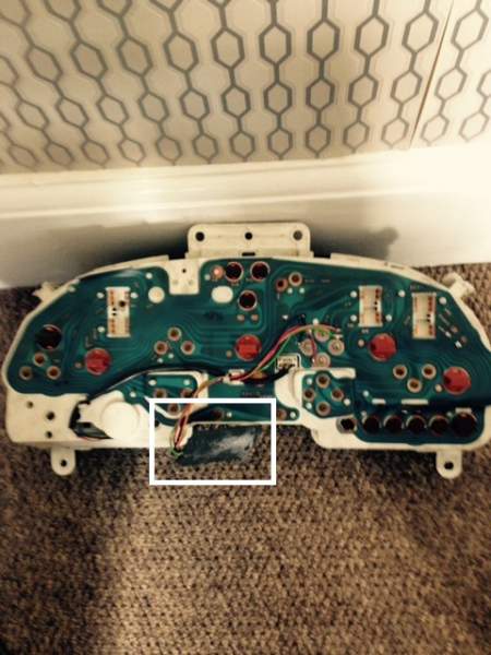

Also...I am confused by the following....the original speedo does NOT have any additional wiring on the back....but the new ZedWorld speedo (which I thought was a UK set) does appear to have additional wiring that I guess is a converter! (Again please excuse my ignorance here)

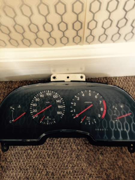

The top one is the chime that everyone disables as soon as they get a chance to!
Looking at your photos, the black faced original still looks to read in KMH? Is that right its hard to tell? If so then obviously it won't have had a convertor, the driver simply had to remember the clocks operate in KMH.
The white faced 'Zedworld' clocks are probably not a genuine UK cluster, but in fact a JDM cluster with aftermarket white dial faces only which happen to read in MPH, but the cluster being a JDM still needs the convertor that the picture shows to make it read right if you understand.

Thanks for the quick replies...so should I remove the two items in white boxes in the first picture?...and if so how?
The converter is the smaller one on the bottom right of your first picture. And as said, the zedworld cluster also has a converter hanging off it.

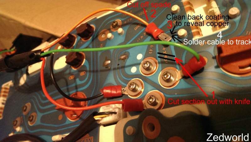

You don't disable the converter, you physically remove it, then join a couple of wires back up. Take the tape off and it should become clear.
Don't know, someone in an earlier post said the chimes stop with a UK speedo anyway, and I've got a UK speedo so never had to look into it. I guess you could just unplug it, the chimes would come from that top box in the first picture.
OK...many thanks...re the chimes...just unplug it?
No, don't just unplug it because the sounder operates for other things as well, like lights on.
I have a saved PDF document that explains how to disable it. The original on line link is dead, I don't know if I can upload a PDF, but if you want a copy PM your email address and I'll send one, its not hard though.
