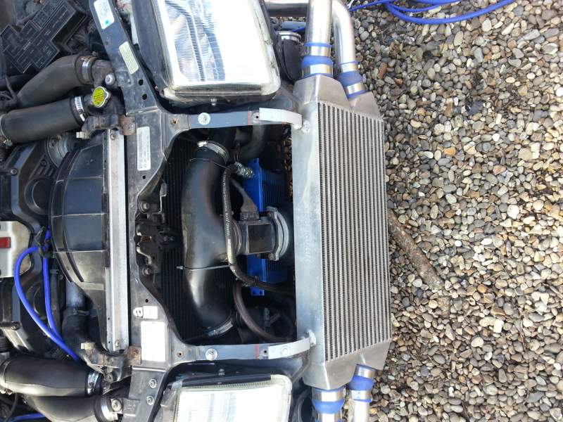

Trying to decide on the route to go down, now it got a fmic at the moment, but I don't like it it's a cheap one and it doesn't fit particularly well,

When u say u went cheap.how cheap and what was it and why not fit. I bought a toyo fmic including all the pipe 2,5 and fittings it was huge.a bugger to fit but it looked well.and never had any issues with it.infact im considering buying another one.and i got change out or three hundred quid.on other dites the same thing was going for seven plus.and it was one peace not an ugly two piece welded together.

I bought it with the fmic already fitted, and it's the same as the cheap one I regretted fitting to my old zed, did absolutely nothing for performance I fitted it because it looked good and at the time didn't know about better smic , it looks similar to yours spin doctor but wasn't a toyo.
[ATTACH=CONFIG]83621[/ATTACH]
That's 2" pipework, not 2.5".
