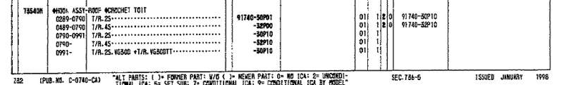

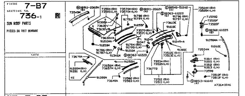

The centre bar ("hook") is the same part number for 2+2 and 2+0.
That's interesting to know, JP. Makes me wonder why Z1 make customers specify whether they need it for the 2+2 or the 2+0....
Hmmm.

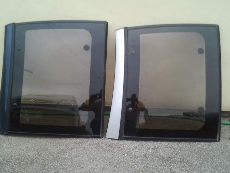

So if the centre hook only has one part number, that must mean that there's no difference in actual curvature or width of the targa glass between the two models.
And I can't imagine that the glass itself is any longer or wider either. So that must surely mean that the only difference between the SWB targas and the LWB targas is the end panel that sits on top of the window glass. Right...?
So that should then mean that you could strip a UK blue glass targa down to the glass, and then simply fit that to a SWB end piece, thus giving you a blue glass SWB targa panel...
...right...?

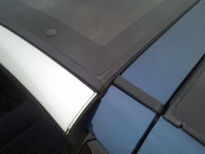

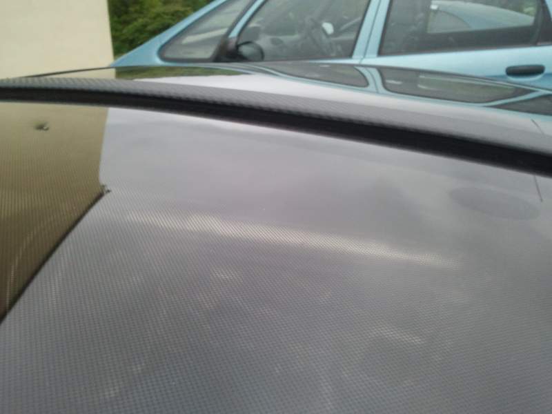

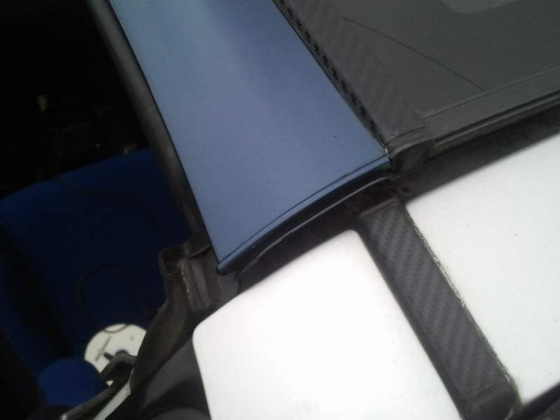

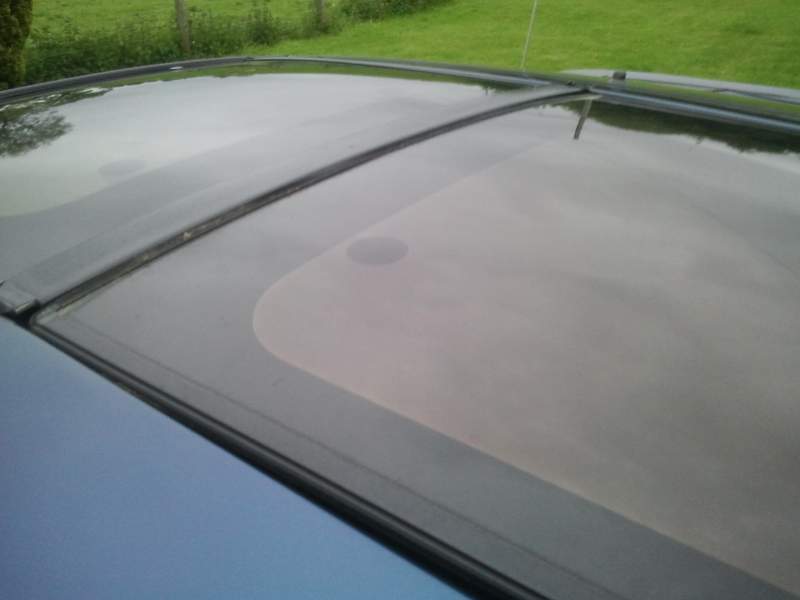

The SWB one looks very slightly more curved imo
Actually Lee you are right. Its hard to see it in the pics but the swb bar sits higher in the middle (about 1.5mm) its not much and I dont know if thats the way it came from the factory or because the swb bar is older and the sun in Japan has warped it over the years. But the new lwb bar does fit as it bolts down tight to the roof. We still need some one to interchange the targs on a roof to be sure.

Well, at least Z1 have sent me the right targa hook (according to that diagram, anyway) :thumbup1:

Neither targa will fit/swap over, I tried them both
The first one with lwb top and the second visa versa, the curvatures are different in the centre bar. The last two are obvious side by side
