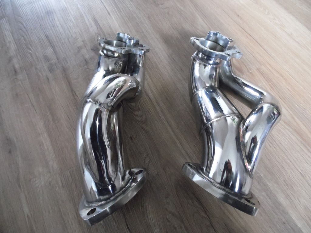

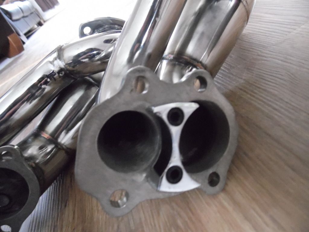

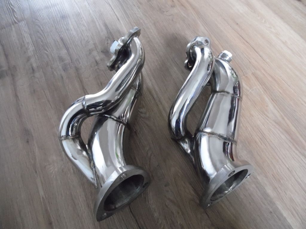

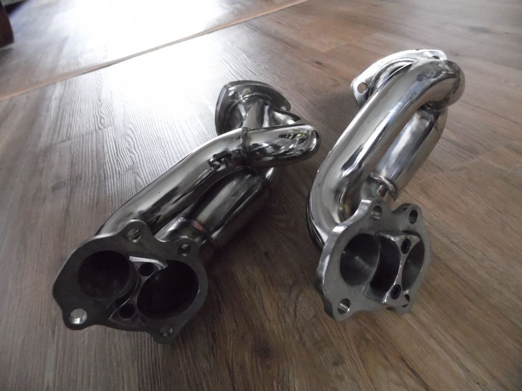

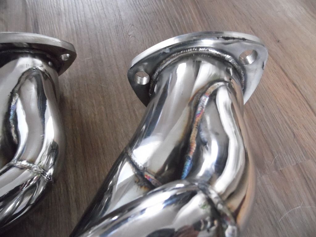

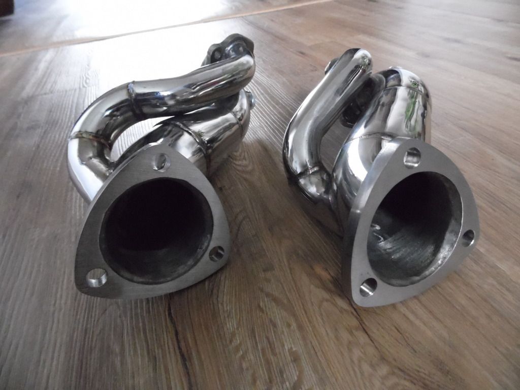

Well, I've just placed the order for a pair of 3" expansion downpipes...!! :scared:
Eeeeek!!
3" expansion downpipes have just arrived!

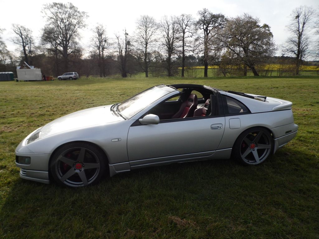

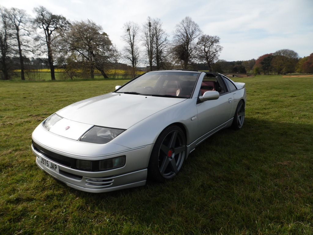

Today, I went and parked in a field at Thorseby Park in Nottinghamshire:
A classic and "modern classic" car show. I tagged along with the Celica Club and it's been a good day, most notably for not winning anything in the show ring (quelle suprise!) but then talking at length to a couple of guys who wanted to buy the Zed and even went so far as to say that she was their unofficial Car of the Show!

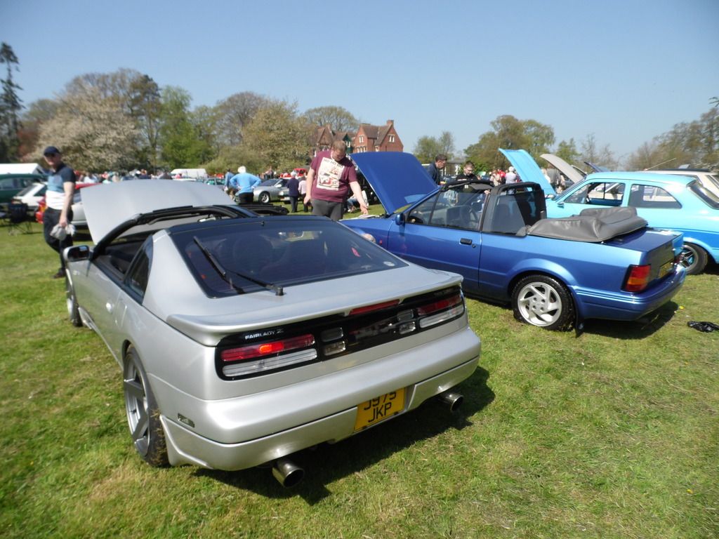

Anyway, yesterday saw me tagging along with a load of Ford boys and girls and heading to a show in Hurworth, near Darlington. I went here last year so, seeing as she's been resprayed, retrimmed and rewheeled since then, I thought I should attend this year too.
There was a good cross-section of vehicles there; from old-school Fords to genuine pre-50s classics, American muscle to 90s Japanese, bikes and Bond Bugs! Pretty much all tastes were catered for and the attendance (from both exhibitors and general public) was massive.
The weather genuinely couldn't have been nicer and I'm sunburned beautifully! The Zed got polished up and looked very out of place amonst a big line-up of Fords :lol:
Lots of positive comments were made and it was fairly rare that there wasn't a decent crowd of people around her, taking photos. :biggrin:
A thoroughly enjoyable day of chilling out and relaxing, with some good mates and some lovely cars. If only all Sundays could be like that!
