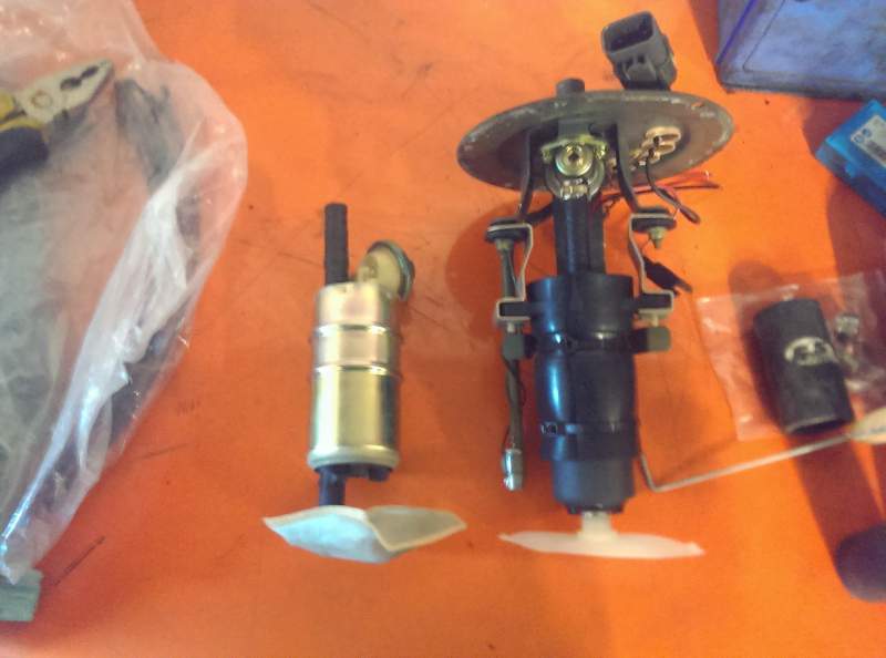

AEM pump on the left compared to standard pump fitted into the bracket:

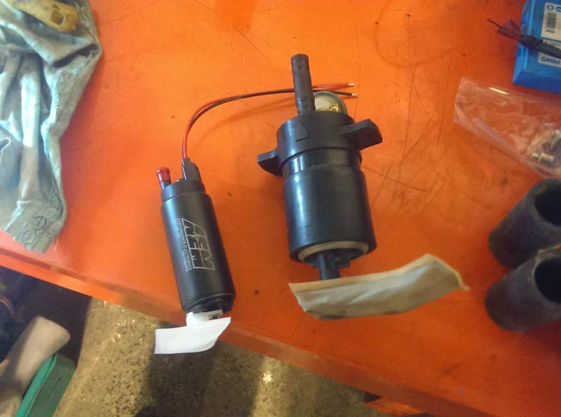

AEM pump on the right fitted to the fuel pump bracket compared to standard pump on the left:
