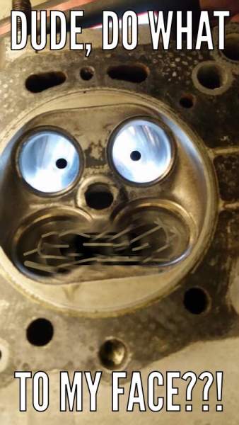

Dam are they replaceable? Also is it just the intake seats or all of them?
