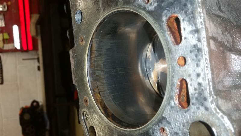

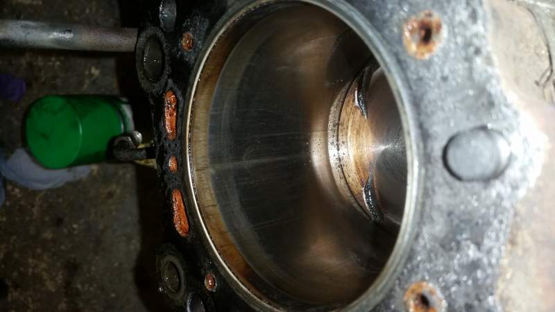

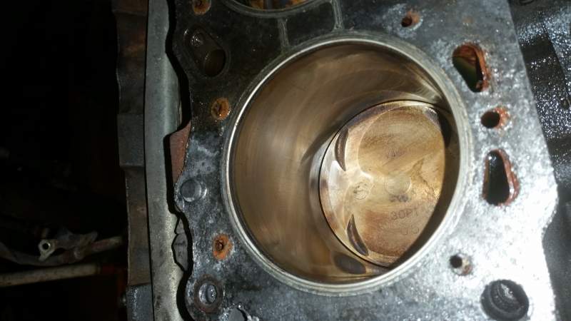

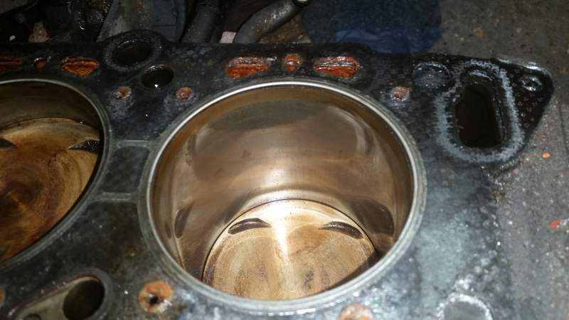

Update.:::
Can you tell why I had low compression strangely the the cleaner of the two cylinders was the lowest compression
The scored one is no4 which read 128psi
No 5 which is the clean one read 75psi I'm going to check the head for any valve damage
That is probably why you have low compression. Aftermarket JDM ECUs are not programmed to be used in the UK. Would have been knocking (detonating) loudly I'd expect.
How long was it run for?
Too be perfectly honest i never heard any knocking or wierd noises from the engine. The ecu was installed when i bought it back in nov 2012. It did run like a pig when i bought it but i got it running really sweet. It Pulled really well. I think what killed it was a few laps of castle combe in japfest 2013 with that ecu still installed. A few weeks afterwards i notice smoke when it sat idling. Went through all the usual stuff plugs, pcvs etc etc. Till beaulieu 2014 when it dtsrted to smoke really bad..! That brings me up to date

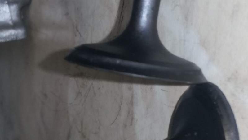

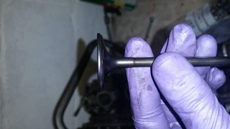

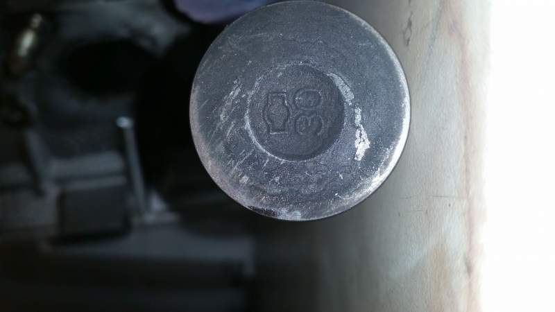

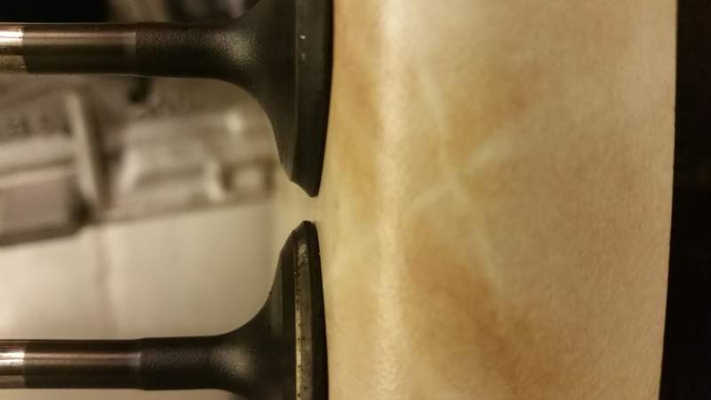

Found my issue with the other cylinder. I have found that my heads were using the early 30 type intake valves. .. can you see the difference... good one on the left lolIMG-20150225-WA0001.jpg
Edited by hellraiser

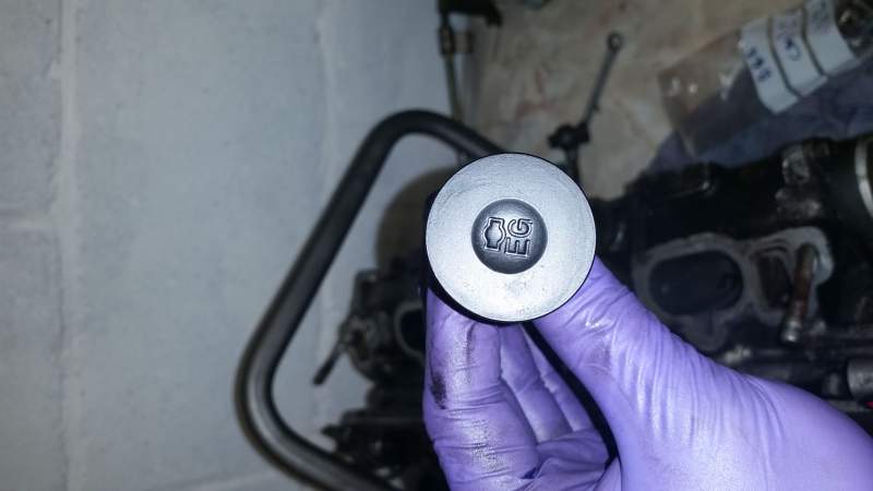

Have a good set of the superior eg intake valves. The condition camparison is well obviousIMG-20150225-WA0004.jpg
