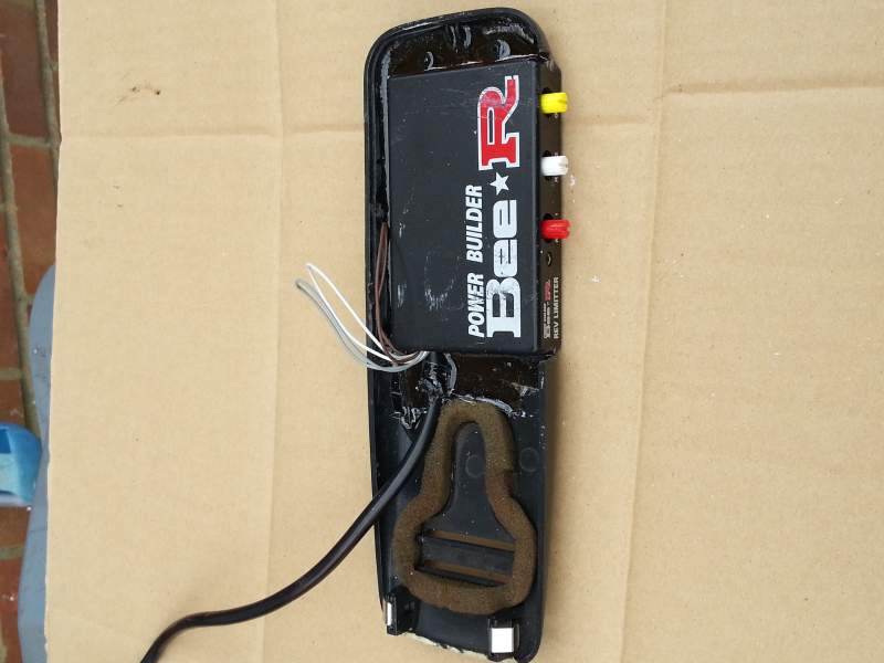

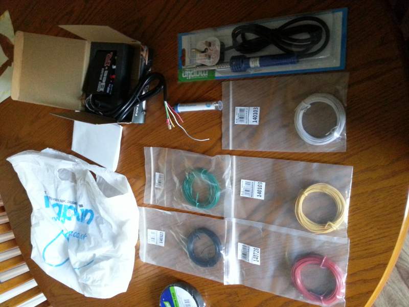

So here we are .as well some of you know i couldnt help myself and bought me a bee r rev limitter.all good.but i dont want it in the boot.but also dont want it stuck on my centre concole or elsewere where it looks like crap and spoils the interia either.now ive found an exellent place for it but for now need to know. Because of were i want it im going to have to extent the loom somw length.my question to the sparkies out there is.is the wire ive bought from maplin thr right stuff ampage wise so that i can make longer.it seems about the same thickness or do i need to go thicker cas of voltage drop.

[ATTACH=CONFIG]83090[/ATTACH]
Cable looks fine mate...swap that insulation tape shite for some heat shrink though or trouble waits down the road:yes:

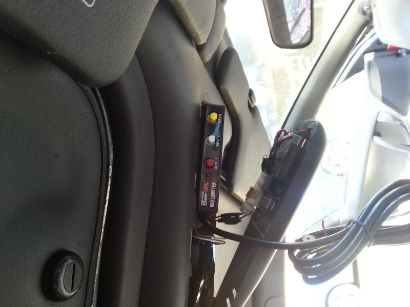

This must be the most easy for vision and acess to the unit and the best bit its going to be semi hidden from sight.you will not be able to see it from passenger side and only just see it from the drivers side.and with easy use.good a.this way i dont have a nasty little black box stuck to the centre consil or out of reach in the glove box.cool a.

Insulation tape is fine, so as long as your connections are soldered or crimped. Terminal blocks are ok but any stress on the cable can cause the connections to pull and snap.
the loom on this will be soldered thus the soildering iron also in the pic and the tape isnt norm black tape its the proper stuff they use so it dosnt put glue everywere when old and hot, proper tape , proper soldering, proper hidden apart from the driver proper job, but yes i wi;; loose the map light, but like i have said before ,i never use them, and thats the first thing i turned off when i got the car. so good alround place to fit.
"Proper job" = soldered connections surrounded by heat shrink.
This! And it's actually easier!
Different trades have different standard practices I guess.
"Proper job" in this scenario is to use heat shrink. DIY job, not trade as he's doing it himself :)

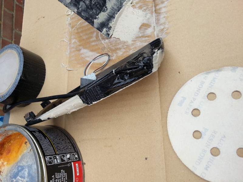

Right and for todays input.

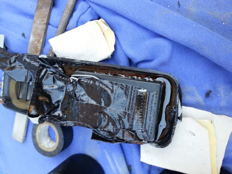

so ive cut out very carfully and then with a file made good.just a drop of superglu to hold temp in place.
Then some resin .being carefull not to get everywere.
then tape up again after trial refit for the hudred times.then a little bit of pooh .there you go funki si some pooh in the to make good and flat.ready for the last stage once ive got it all nice.

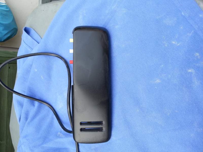

And at last .with the pooh rubbed down.to the final stage tomorow.the apllication of the leather to finish it of.
its all in the prep a.

Yes i know but i didnt want a loda boxes of trix in glove box.and if i feel i need to have a play.i can access it without any trouble. Oh and at the moment the car seats so low i couldnt go there even if i wanted. But Noels right i did want a disgret place so i could play without spoiling the interia. Tomorow ill post the finished result.your going to love the finish
