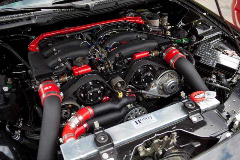

Saw this on the US site, thought some of you guys would appreciate it, 284hp out of a vg30de.
I'm liking that. Just needs 2 turbos on it now :wack:

NO it doesnt:tt2:
I wanna know if they are American horse powers or UK hps.
I also want to know how he has achieved it:yes:
It's all about the high-comp turbo setup :D

The car does have an impressive spec list. It was owned by Shawn Holleman who used to work at Z1. All that work though....and still less power than a stock TTZ. :p
Cheers for the extra info Si, as you say all that time effort and money to get less than a stock TT... I'm sure it's responsive and fun but hell. From a techno geek point it's very cool but considering what you could have if you had pumped that time and money into a VG30DETT instead is sickening, I bet that money could produce a 500hp TT
horses and courses comes to mind.
I bet the list of changes to this is huge. did anyone have luck finding a spec list
