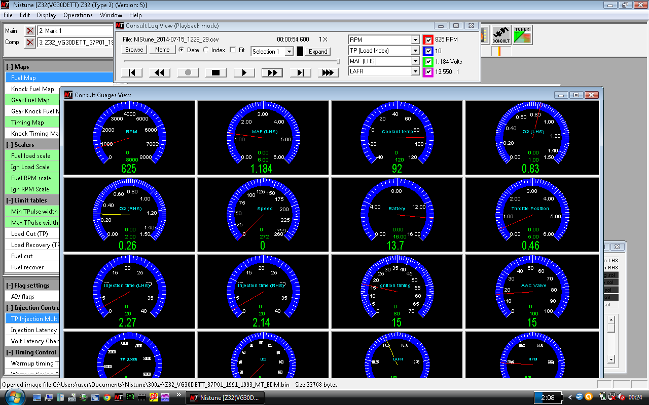

Sorry Madkiwi, I hope you don not mind a slight post hi jack.
Noz, Would you cast your eye over these reeading please?

Given Noel's comment and gonna be cheeky and say your AAC should be 15 lol
Get it on 15% before your engine holes a piston! Quick!
OK then, major assumption I'm making here is that those values are in a stable condition, say after 1 minute of idling at the very least. If not, the following observations are pretty worthless :D
The O2 sensor reading is in %, so 0% is 0v and 100% is 1.5V (1500mV). The switching voltages are at 0.48V (32%, falling) to force the AFR rich (14.7:1) during a rich condition. This is lambda feedback. RH Pulsewidth looks a bit high at 2.23ms hence the 92% & 80% O2 values (plus the "rich" flag of course). I would expect LH pulsewidth to be higher than RH. Air Flow % is typical for idle condition. At idle, the stock map has an estimated pulsewidth of around 1.5ms, interpolated from 4 load/RPM points. But this is overruled by lambda feedback. I see typical values around 1.9ms.
Fuel temp at 43° so I would guess the car has been idling with the bonnet down for around 10 mins after getting up to temp, or with the bonnet up for around 15 mins. Ambient temp approximately...... Lol, just kidding! :wack:
Below is a Zed at idle with a faulty RHS O2 sensor. You can see that the LHS O2 reading is at 830mv (rich condition, lambda trying to force the AFR lean). The LHS pulsewidth is 2.27ms. However, what I have is a realtime AFR readout, denoted LAFR, showing 13.55:1, which is a rich condition.
I would expect your car to be idling around the same AFR at the time that screenshot was taken. Not due to faulty lambdas though. If the O2 sensors were constantly low, the ECU thinks the AFR is less than 14.7:1, and so extra fuel is injected. This is why it's OK to unplug O2 sensors as they sit at 0.31v (which is less than 0.48V) and so the resultant AFR is always going to be richer than 14.7:1.
In your case, the lambda sensors are seeing a genuinely rich condition (voltage > 0.53V/35.3%), so the ECU should be pulling fuel by reducing the pulsewidth, then when AFR gets lean enough to reduce the O2 voltage to 0.48V (32%), the ECU will add fuel to try and keep AFR stoich, and so on ad infinitum. You can see now why if they're not stable values, I've written an essay for no reason!
