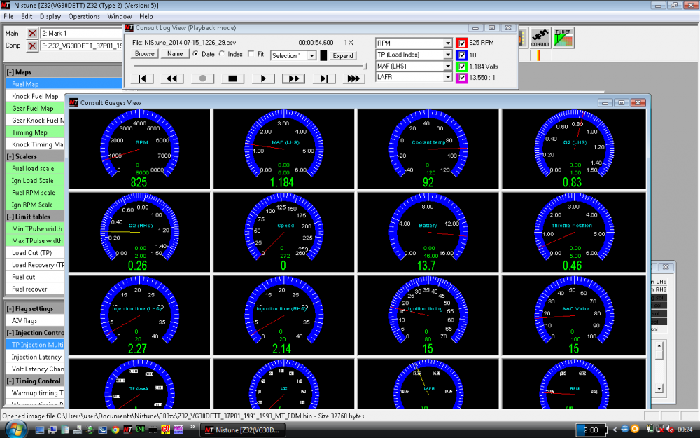

This is what I recorded yesterday using ECUtalk. I edited the video down to 4:15, just from the time I got on the interstate and exited again.
Apologies for all the clicking picked up by the microphone, the only thing I can think is it was rubbing on the leather seat?
I think everything looks normal. Car did not go into safety boost, which is what I was hoping I would get so I could record what the engine was doing when it occurs. My theory of a faulty MAF seems to be disproved by this recording, at 6,000 rpm with 3.26 volts on the throttle (and about 10.5 psi boost) the MAF was at 4.16 v (this is at approx. 110 mph, in 3rd gear- automatic transmission). However, the MAF was showing a bad reading with the ignition ON (engine not running) of 0.44 with a voltmeter, ECUTalk recorded 0.08 volts. Service manual says it should be 0.8 volts.
ECUTalk could not read the speed, I believe the consult adapter I got on Ebay is faulty. It also causes a code 14 Speed sensor fault, and sets off the HICAS warning light, and to make things just peachy it puts the power steering into "high speed mode"- fine for the freeway, not so great on city streets. Removing the consult adapter from the vehicle's plug restores everything to normal. So I am asking the seller for a replacement adapter, assuming this one has some kind of internal short.

It may be me, but could not see any correlation between the TPS voltage and the RPM.
Unless I am mistaken, at one point you had .46v at idle and again .46v at 3000RPM
maybe I need to watch it again.
Interesting though.
I remember that part of the recording, I took my foot off the gas (technically throttle was at idle) to slow down as I was catching up to traffic (happens quickly when I am doing 115+ mph and they are doing 75).
Apparently the better correlation is throttle voltage and airflow. Here is a graph of RPM, throttle position and airflow. Time is first 1:52 of the of the youtube video. One thing I learned from graphing it was that there is a lot of shakiness in the airflow, especially at closed throttle. That indicates vacuum leaks. And I thought I was on top of them...

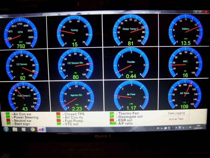

I've not watched the video, but you need to wind the IACV screw out a bit, it should be reading 15% on idle with all accessories switched off.
I thought it looked a little high, then I found this on the Z32 Wiki-
"...generally, when warm, the duty cycle is around 30%. If the number is 15% or lower, this often means a vacuum leak is present, as 15% is the lower threshold of the AACs operation, and this indicates the ECU attempting to lower the idle speed."
http://z32.wikispaces.com/Consult+Quick+Reference
It was the only reference I could find to what the AAC duty cycle should be.
I've never seen it lower than 15%.

As for AAC, mine settles at 15% when up to temperature. Could this mean I have a vacuum leak then?

No. It doesn't mean that in the slightest. Read post 6 :laugh:
30% at warm idle means the IACV is working too hard to maintain the designated idle speed. I don't care what Z32wiki says, that is plain incorrect in practice. Unless you enjoy revs dropping low at every junction :wack:

You may have a vacuum leak, but that is separate from IACV setup. Perform a boost leak test. Then after any issues are resolved, recheck the IACV value & operation :)
The manuals are a good set of instructions for a brand new completely stock 300ZX, but when it comes to a car that is 20+ years old and more than likely different to factory spec, they are simply a guideline.
EF & EC-38
Idle timing 15°±2°. Nope, 15°±0°. It is imperative base timing is set at 15°. If you can't get it exactly on the 15° mark, make sure it sits just to the right, ie less than 15° and slightly retarded. Never higher, not on these cars, not in this country.
AAC valve 15 - 40% (NA); 15 - 35% (Turbo). Nope, 15%. See post 6. Every Zed that needs the idle setting up I set it to 15%. I could set it to any %, but I always, without fail, set it to 15% for the specified target idle RPM. They idle perfectly like this, it is not a brand new component. No need to unplug the AAC valve, disrupting a 20+ year old wiring loom is a bad idea.

Real readings from stock NA auto this am
When cold: AAC 80, 1250 rpm
within a few secs: AAC 54, 1200 rpm
after 6 miles: AAC 34 in the instant after shifting into N which then sank within a sec or so to 15 and 810 - 850 rpm
AFM @ 1.23 at warm idle
It's noticable that sometimes it idles at 850 - 810 and sometimes it drops to 750 - maybe it takes time to settle.
But in any case, the guy's (I usually rtfq as well as rtfm) q was does this all look normal. So was his 24% after he'd let it settle to steady idle (in which case it's too high according to some but within the manual limits) or while it was just on the way down (in which case what was his steady idle AAC).
The rest of it I wouldn't dare comment on without rtfm.
