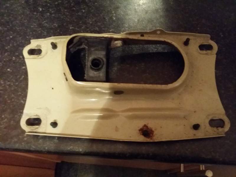

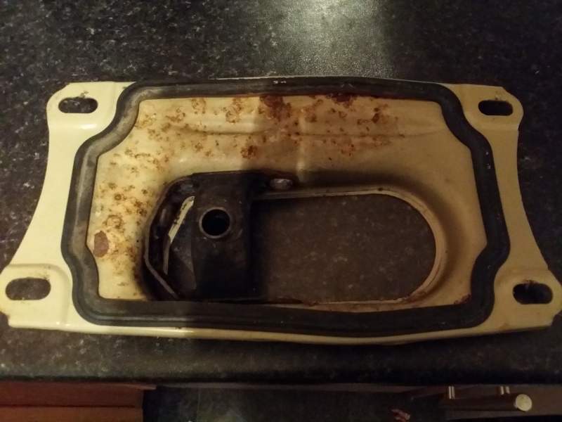

Please see the attached photos for reference. It seems the gear linkage has just snapped off. Some people say it is a common problem, but i cant find a replacement anywhere?
This is the part that is broken, its connected to the gear linkage, but its totally snapped off. It wont pick up any gear at all.

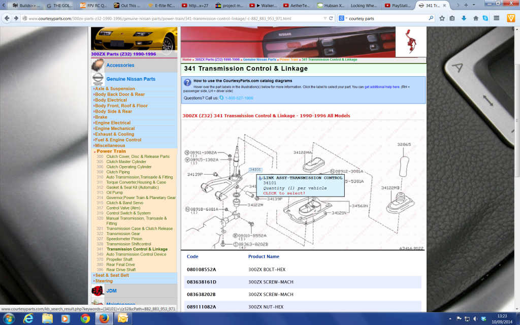

Found a place in USA, that can supply it. But £100 is very expensive.:huh:

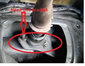

Just wondering if anyone here can help? Any one else come across this issue? Or anyone local i can buy the part off?
thank you for all your replies. But how come this looks different to the part i need? i thought i needed the new triangle type part?
The rubber is more than likely to have given way rather than that pin breaking!
Can you whip off the gearknob, take out the leather and then rubber gaitors and take a close-up photo?

Thanks for all your comments!! Appreciate it all. Well i heard a big snap noise just before the gears dropped. So i am assuming it is the pin that broke, dont know why.
I will try posting some more pics, but at the moment it is at my mechanics.
JaiKai please can you post a pic of the triangle part as i am keen to buy that and see if that does the job.

Not trying to say the abvious but you sure the bolt just came undone.
If you pull the knob upwards where it should be and hold it can you not move gears?
As that should be achievable even with that bolt snapped.
Mind to hold the clutch in rather than force shifting.
