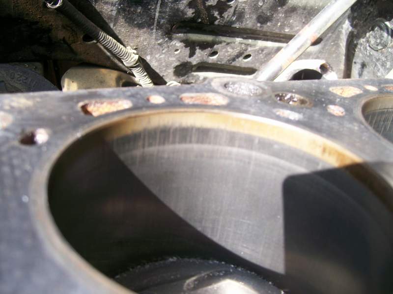

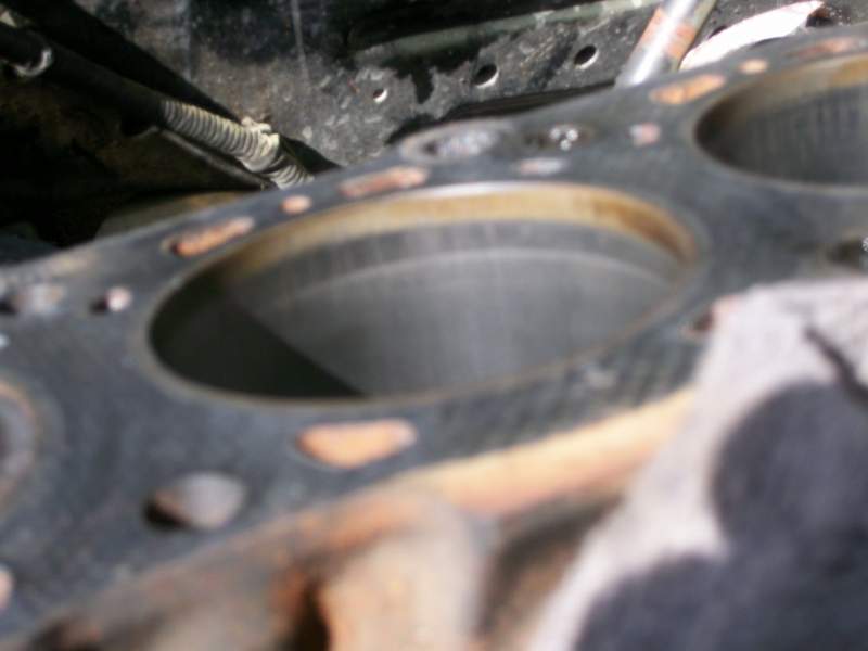

Spent days cleaning and prepping the head ready for new valves and stem seals, cleaned part of the block today and noticed this, scoring in the bores and in one cylinder if use my fingernail, i can feel the scores.
Is this still useable or is it block out to be honed, then i guess over size pistons etc.. camera not great, this is about as close as i could get
Yes just about, but not all the way down the bore, only at the top

I expect rather than a totally healthy 160 psi per cylinder it'll just be down a bit.
Is what you're seeing just wear and tear ?
As far as i can tell its normal wear and tear as this is the first time the head has been off and the head hasnt been skimmed before, where as the replacement heads i got have been skimmed before. The rest of the bore looks fine, just seems to be at the top end of the bore.
I may for now give it a rub with emery and put it all back together to get it running, then when i get time will get my spare block re honed and go for new pistons etc, service the spare heads ive got and eventually end up with a nearly new engine to put back in at a later date.

Those will hone out no probs Graham but not with the motor assembled ime affraid to say.

Honing kit lol, engine out and block apart for that though
Thats what i was afraid of, i wish i had just pulled the engine out now instead of stripping it in place. Ive spent so much time getting the heads right, it seems pointless putting them on a duff block :thumbdown:
I guess honing with a diy kit will not remove enough metal to have to go over sized with pistons and rings, although new rings for def if im going that far with it.
I'd agree with that Graham, i did have a honing tool for my 49cc little cylinders that i no longer use, as i fubared it as i got it caught in the finned vents that my cylinders have but the bit it did near the spark plug it did very well :cool3:.
Machine mart do an Heavy duty honing tool about £17 .. you will need med compound pads ...
rotation speed when using it needs to be slow and oscillating it up and down .. remember to use a light oil too ..
This is the finnish you want Graham and completly wash the bores with dish detergant and water after and once completly dry and straight after rub the bores with clean engine oil or they will start going red in 1 hour.

Thanks guys, when honed, will i have taken enough material off to worry about bigger pistons?
no but new rings is a must Graham
Cool thats what i had hoped, replacing rings are cheaper than getting pistons too, although if im going that far into the strip down i might look into it and have myself virtually a new engine when done :thumbup1:
you might as well throw a set of rod and main bearings at it too mate...Noz has a set for sale i think
Agreed, it would be illogical to go that far and not change the bearings.
