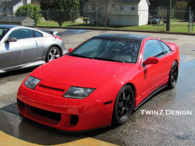

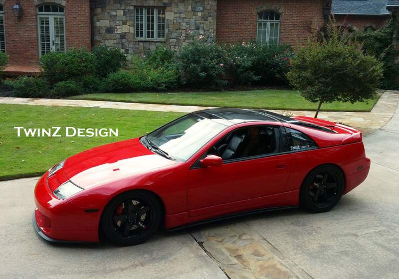

New front end.smothed out arches so that hole on the side is going.type two rear spoiler.and 99 rear spec lights.hope that pleases sir?oh and loads of bling under bonnet.

Sounds pretty good! Worried about the 'new front end' though. :(
I'm hoping he's going to say stock or 99, I never like the storesk one it had personally, it's my second least favourite over the basking shark.
