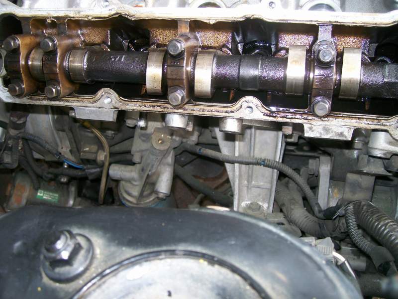

Now with the rocker covers off all 4 banks, when i rotate the engine, i cant see if oil is getting up to the rockers, although there is very dirty oil in all 4 and ive noticed in most i can depress the lifters slightly, which would have been giving me the tappety sound, but nothing jumping out at me that is giving the really bad rattling/tappety noise when the engine is running. The only way i can describe it, to give an idea of what it was like, having a metal disc flapping against bike spokes, like when you were a kid and used a peg and some plastic to make that silly noise lol

Im quite looking forward to getting down to the block just see if those check valves and squirters are blocked, which im certain they must be, with oil starvation to the right bank, hence the bad rattling of cam lobes on the lifters.

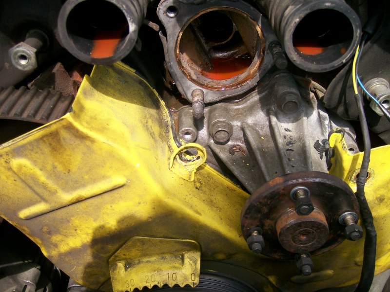

Notice the oil in the lower plenum intake

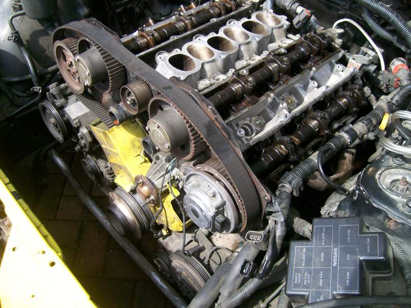

Got the under drive pulley off and belt out and i think i may need to replace the cam belt pulleys as there is a few mm movement

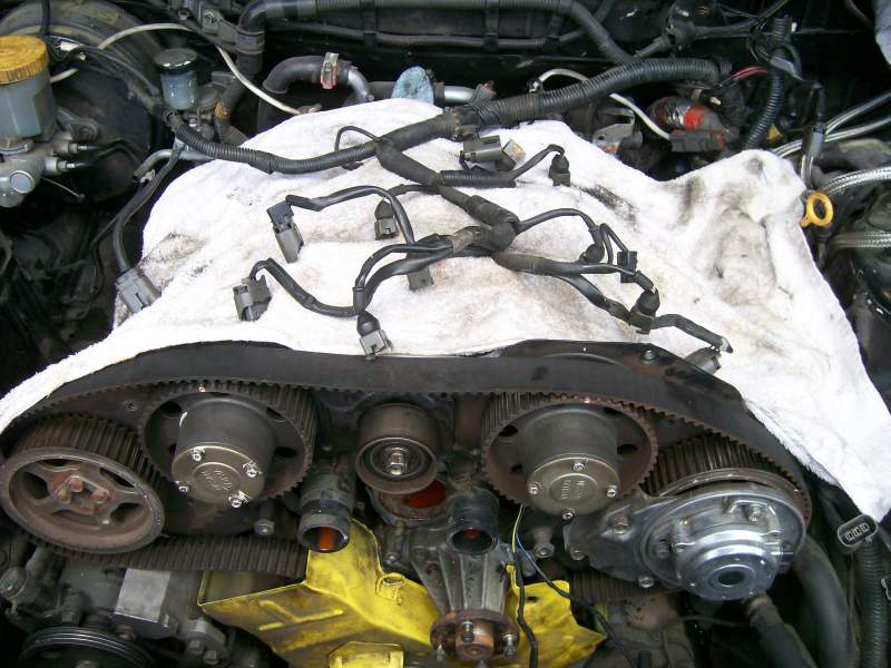

Got the manifolds off and the cam pulleys on the drivers head removed along with the back plate, other side tomorrow, then heads off, deep joy lol

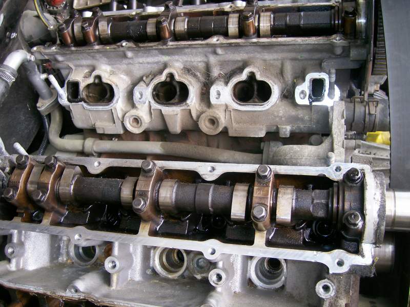

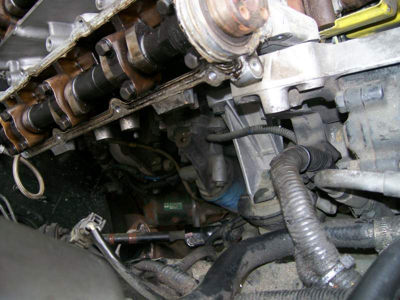

Got the drivers head off and apart from a couple of sludgy journals there is nothing obvious as to why it was making a racket, a little play in some of the lifters, no marks on the cam lobes and finally a little movement in the pistons, which after some research is normal, ie slight back and forth movement by a few mm not up and down lol
