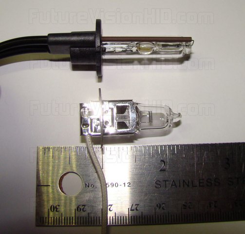

Thanks, I know that when I installed my H3 HID kit I compared the two side by side. The halogen filament was bang in the
middle of the HID discharge bubble (like this photo I pulled from the web).
I could try moving the HID bulb back in the holder to see what difference it makes, if any to the pattern. I still think the
best solution for me is to retrofit a complete OEM HID projector assembly.
