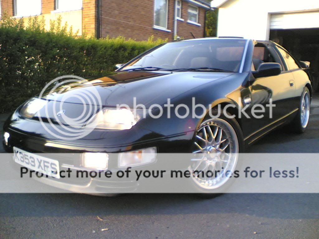

weird front indicators
You are better getting a second hand set of Jap indicators. Dont know how you ended up with UK ones on a Jap import.
previous owner gave them to me , they are the same like this ones I believe
http://www.zcentre.co.uk/index.php?page=shop.product_details&flypage=flypage.pbv.tpl&product_id=223&category_id=61&option=com_virtuemart&Itemid=7
it says they are not designed to illuminate but I guess if u put bulb should be fine . I like them to be honest , they look nice simple , tinted etc .
They're fine to drill out. I took a set over to the US and drilled the holes out and they're now in the silver 2+2 I use out there. Just measure the bulb holder with a pair of vernier calipers and buy yourself a driller cutter to the same size as that, also a file for the tab locators.
Easy enough to do.
