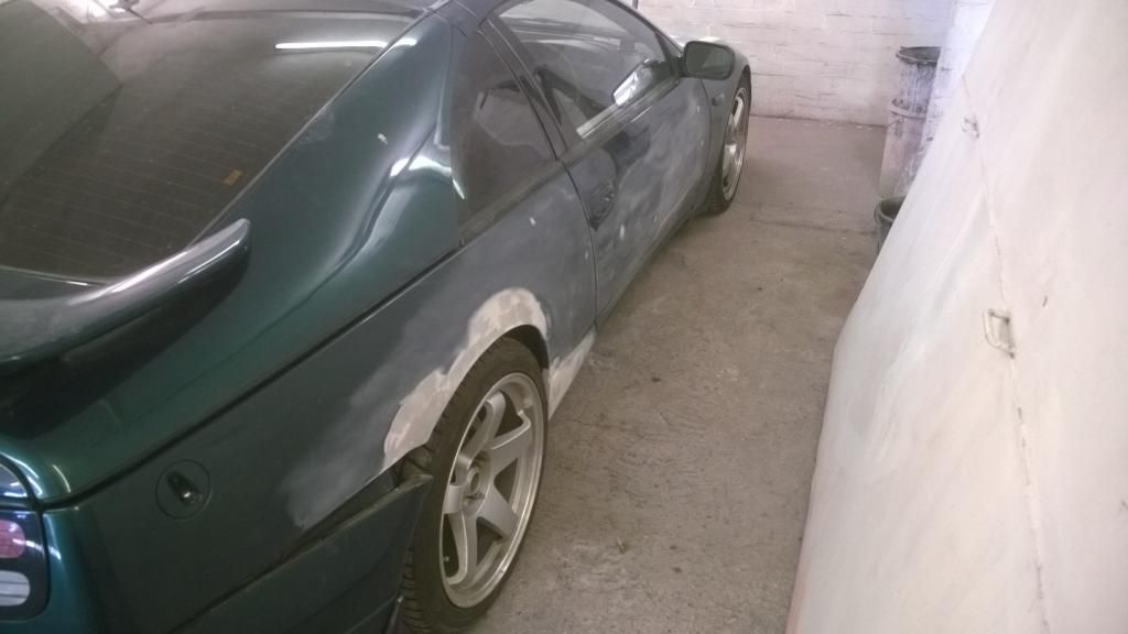

The following pics show what we found and how it was fixed.
Nearside Rear
Offside Rear
Near side rear Internal OMG !
Rusty bit discarded
Nearside Seam Welded
Nearside Tyre Fail damage some scaring still visible
Tyre Damage fixed
Offside Internal
Offside Rear Throw away
Offside rear Seam welded
Arch Rolling Rust removed
More shown by Arch Rolling
Even more form Tyre/Arch Rolling
Rear Bumper Mount 1
Rear Bumper Mount 2
Rear Bumper Mount 3 – at least the hole is whole !
Rear Bumper Mount repaired
Bonnet Straightened and Supermarket Trolley scrape done
Door dings done – No More parking in Supermarket car parks
Offside door dings done and wheel arch prepped
Boot Seal prepped – pressure washers DOH !
Nice new Sill
Nice new sill again… and no we haven’t run over a guy in check shirt !
Rear Arches now now flared subtely

No I didn't know and Jeff was surprised as well. It first showed up really bad when the guy rolled the arches and we thought if was that but when it went up to Guys and he gao on his stands he saw the rear sills and we told him to do them ! Just as well because that has got all all the rusted metal out. He's done a super job of a the subtle flare to get the Rotas in as well The pictures don't it justice.
The main thing I'm pleased about is that there wasn't anything rusted in the main structure or chassis Having the bottom of car covered in oil probably prevented that !
He's removed all the rust, and is undersealing everything everwhere whils he's got the bumper of because although he's said he had to do quite a few rear bumper mounts he says he only wants to do them once !
It's funny because I'd arranged to have a complete repaint done in about six months, but with this work every panel has been painted, wasn't the intention, just the way it worked out

I think he did it when he cut out the rolled arches and before welding the new metal He sort of made the arched metal from the inside of the rear wing and then made the new metal to fit that shape and keep the bottom flat bit
I'll put up some more pics later because from some angles it looks very sharp and others it looks subtle I haven't seen it yet but when I get it back I'll do some more pics

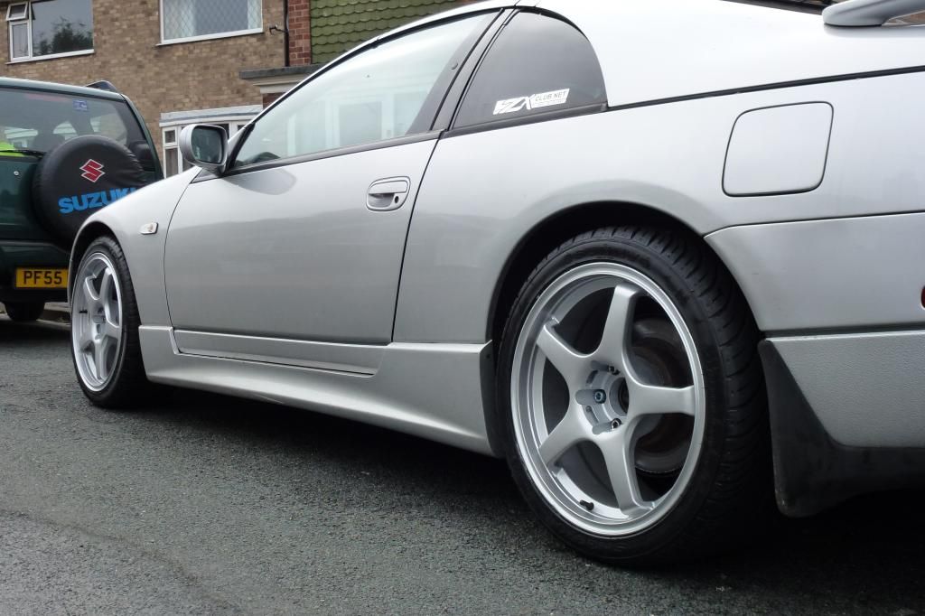

They're Rota GTR wheels 18x9.5 with a 30 offset we had to have the arches rolled because otherwise the tyre was rubbing when the coilovers were lowered
These were originally on mine and there now on Jan's zed The rears are 18 x 9.5 with an offset of 35 Running with standard shocks
