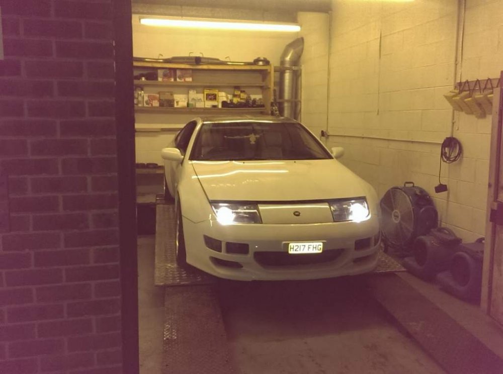

I have my own dyno, have had for some time.
As I have already said, the Selin issues were being investigated and I was travelling down to Bristol each time to do so. Speaking to SZ and using a map provided that was proven in the States, the issue was still apparent. This was done to prove a point. It wasn't a case of chasing the issues blindly, you don't "know very well", I'm afraid, only what someone else has told you. The owner didn't spend a lot on new parts, and subsequently the car was written off before further testing was completed.
I didn't, and still don't have time to investigate an issue with a component sold by someone else when similar power can be made without the component. Especially after discussing things with a vendor in the States unfortunately went nowhere. It's possible to run a dual intake without the Selin and a secondary MAF on the stock ECU, at any rate.
Would that be this ?
Yes, during the moving in process.
Also seen here:
