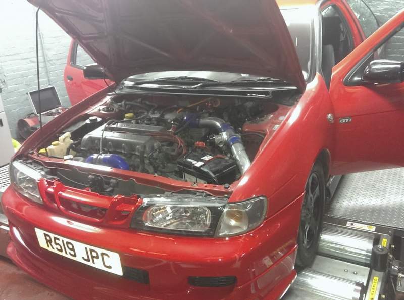

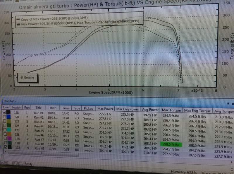

With regards to completely bone-stock NA Nissan engines with a turbo strapped to them, here is one I mapped last night completely from scratch on a £40 SR20DE engine:
Not bad at stock actuator pressure of 0.55bar on a T28H. Completely maxed out the Almera MAF at 309bhp & 297lb·ft. Fun car, quite a handful for me on the dyno.
I'm looking forward to some VG30DE-T builds in the future, who's game? Howard, your car was immense. You will love it when you get your hands on it. Might need better brakes...
